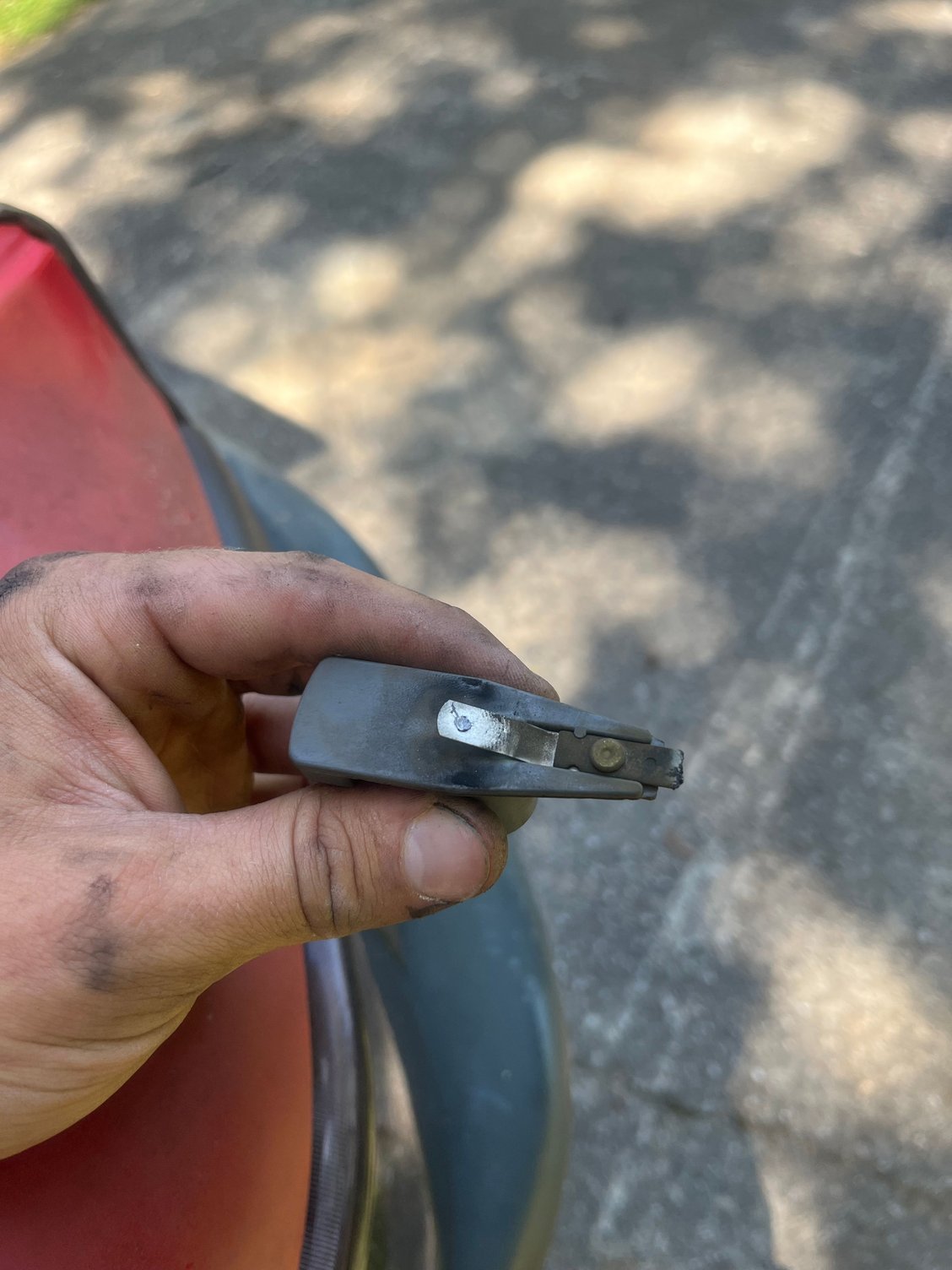

I found this when I was checking the ignition coil pick up and I took off the crank position sensor crank position sensor visually doesn’t look too bad. There is some dust and some metal shavings on there, but not too big of a deal. The ignition will pick up. I feel like every Dodge I’ve seen or every time I replace this or take it out it’s always bent in the exact same way every time.

I replaced the pick up rotor button and cap for the distributor. Still nothing cranks from adding power to the penny seven nothing from the key switch.
