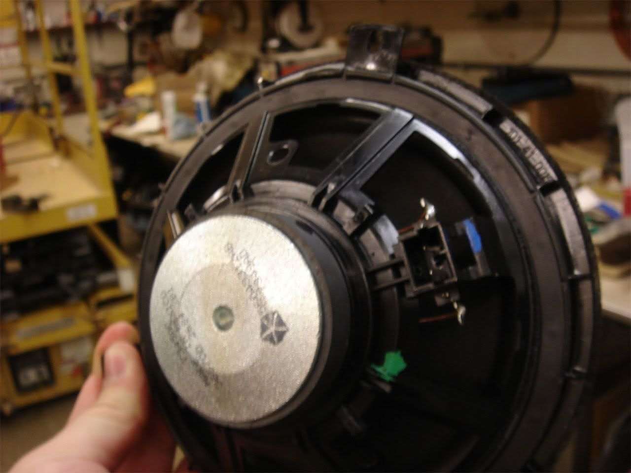

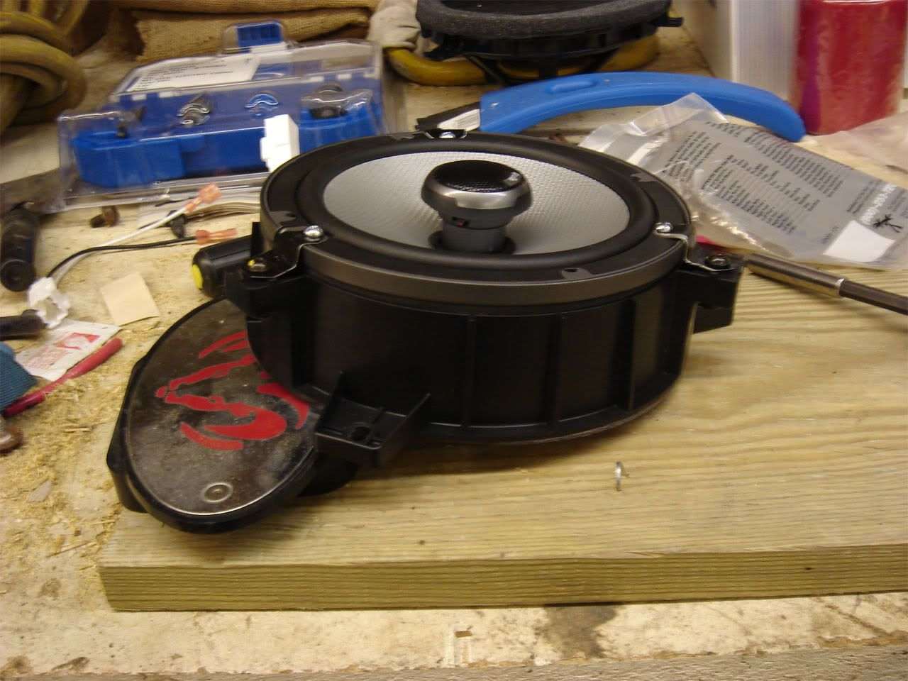

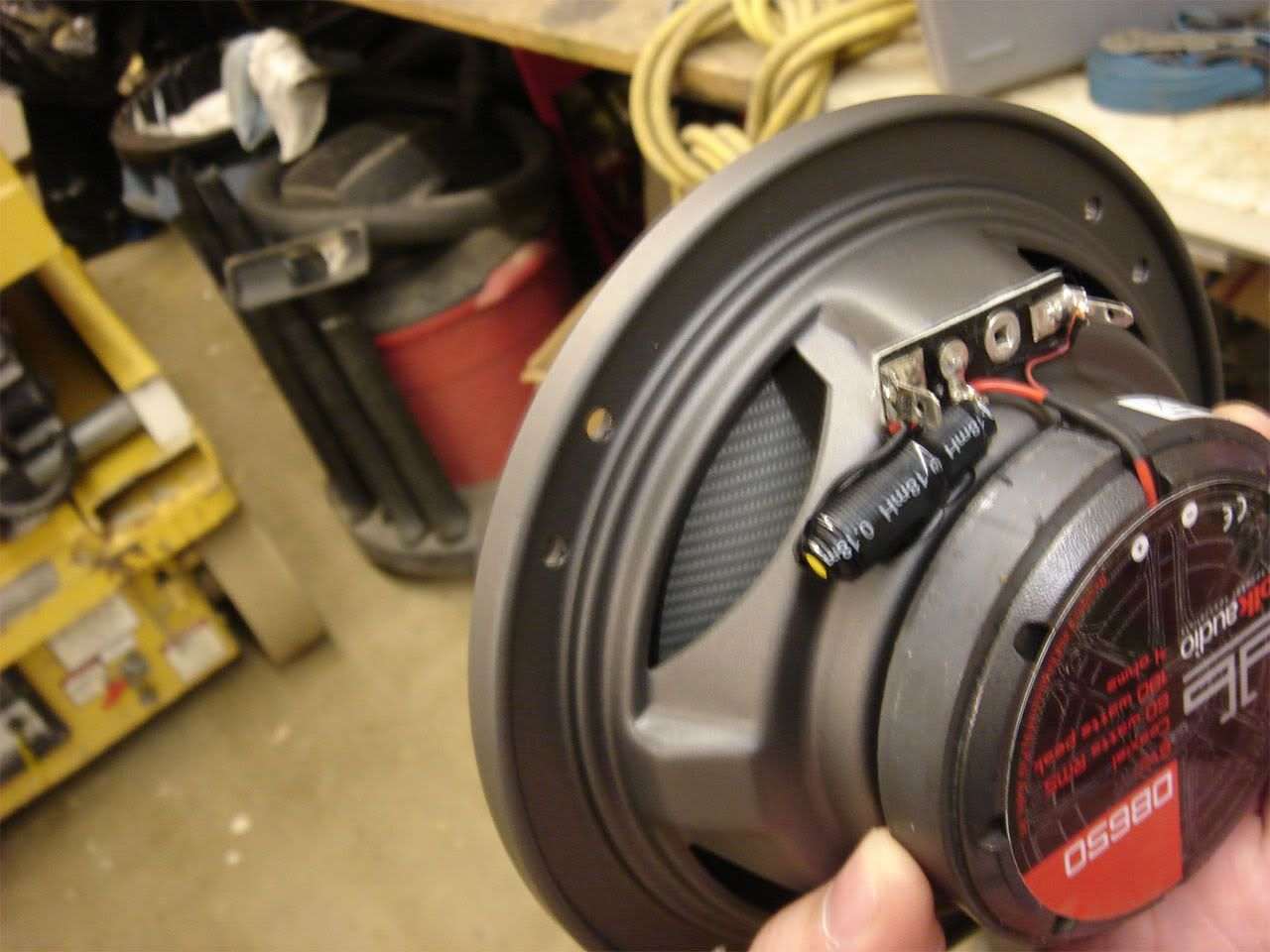

Now that the panels are out of the way locate the speaker at the bottom of the door towards the front. It should look like this:

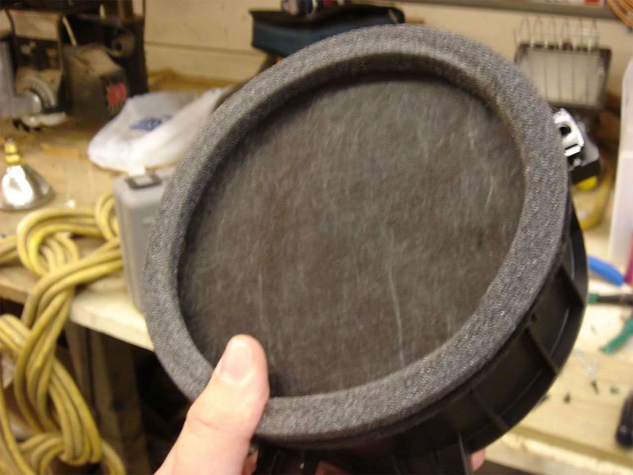

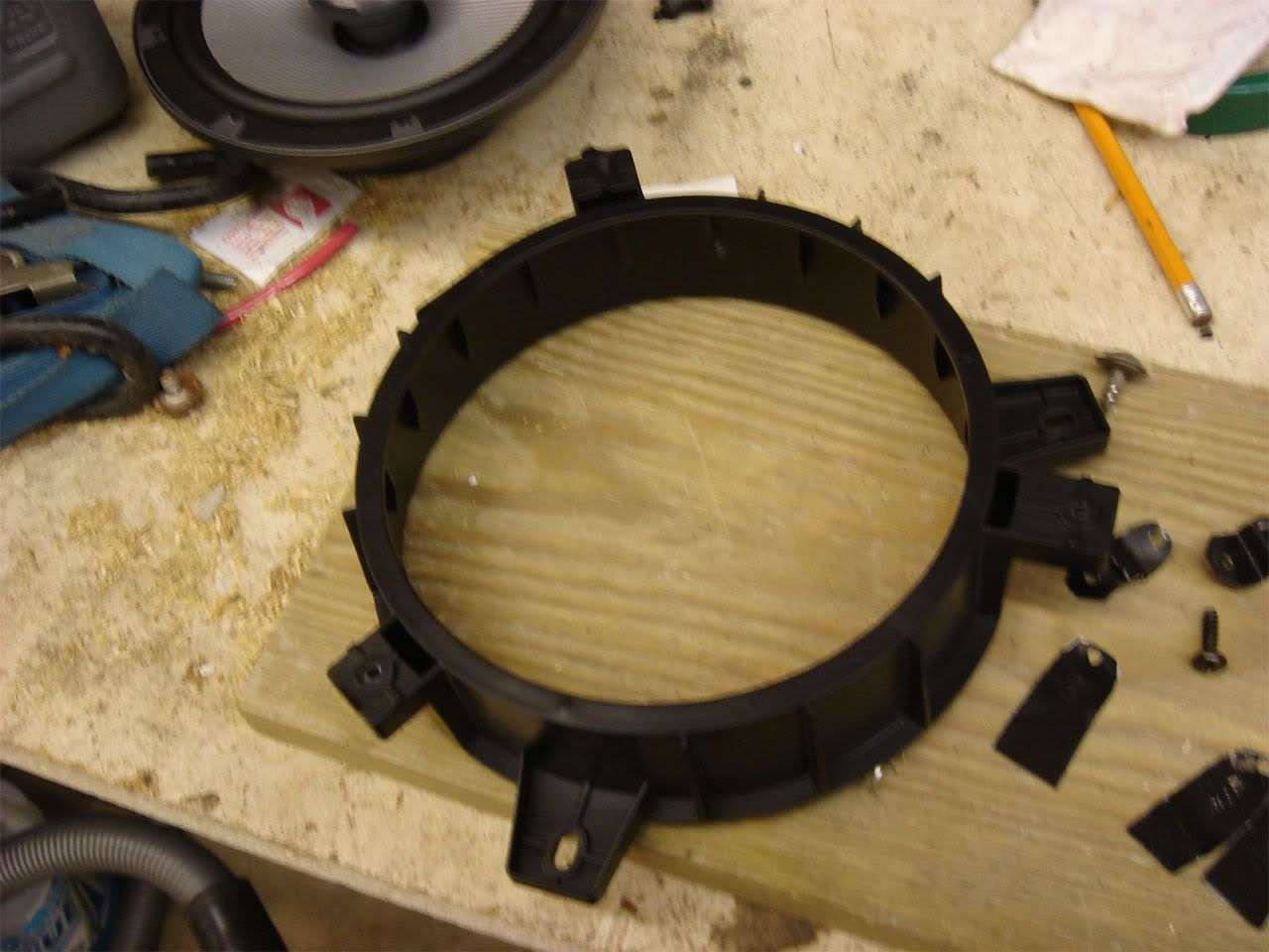

There are 3 screws holding the speaker bracket to the door, take those out and remove the speaker. The wires are plugged in on the back of the speaker, just disconnect the plug. Now take out the 3 screws holding the speaker to the bracket and pull them apart. You'll end up with this:
Out with the old:
In with the new:

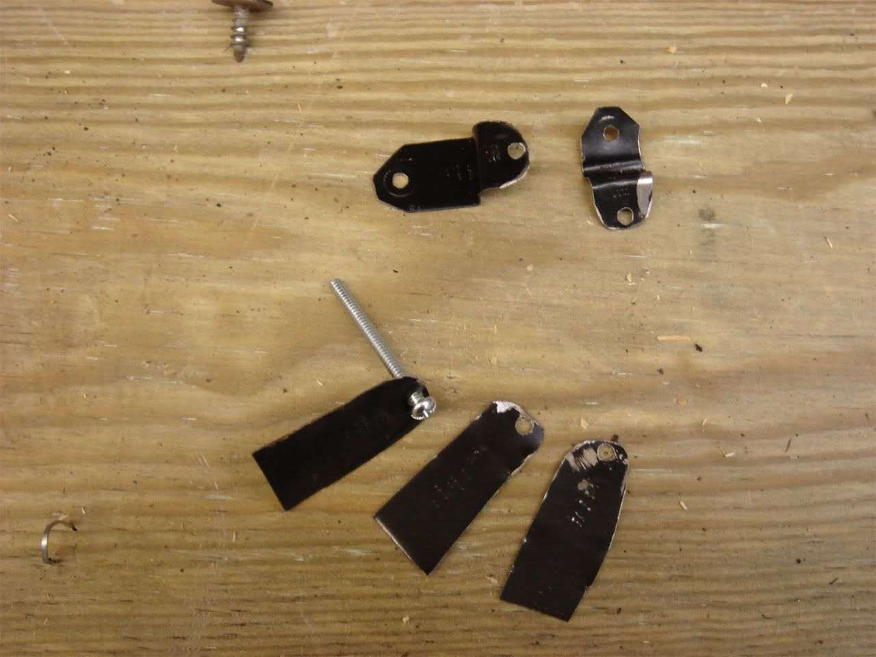

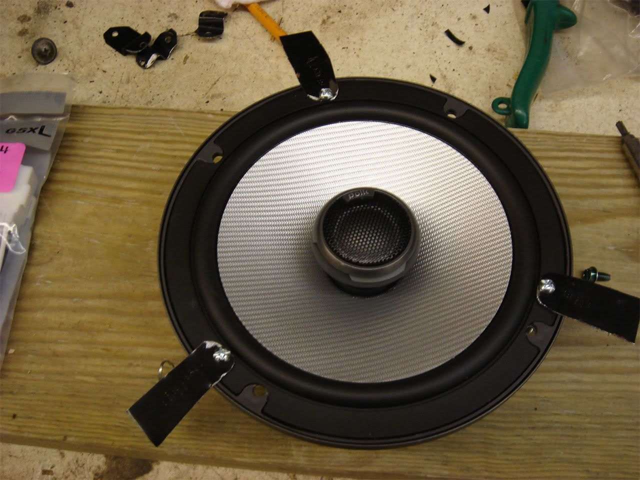

Now you may have noticed the factory speakers mounting points stick out beyond the speaker, something aftermarket speakers typically don't have. I made my own brackets for this, it's pretty easy to do. I took some sheet metal I had laying around and cut 6 strips of it roughly 1/2" wide by 2" long. I then took a 7/64 (#35) drill bit and drilled a hole as close to the end of each strip as possible.
Ignore the two at the top for now.

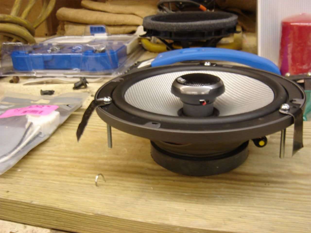

As you can see in the picture I also rounded off the side I drilled the hole on. This will be going on the speaker and you don't want any sharp edges sticking out that might puncture the rubber surround. Next place a bolt through the hole in the bracket you've just made and place it on the speaker:
Now bend the bracket down 90 degrees at the edge of the speaker:
Draw a line on the brackets even with the bottom of the speaker mounting ring (where it would sit against the bracket). Now bend them 90 degrees the opposite way of the previous bend so it looks like an s.
Look at the two top brackets in this picture:

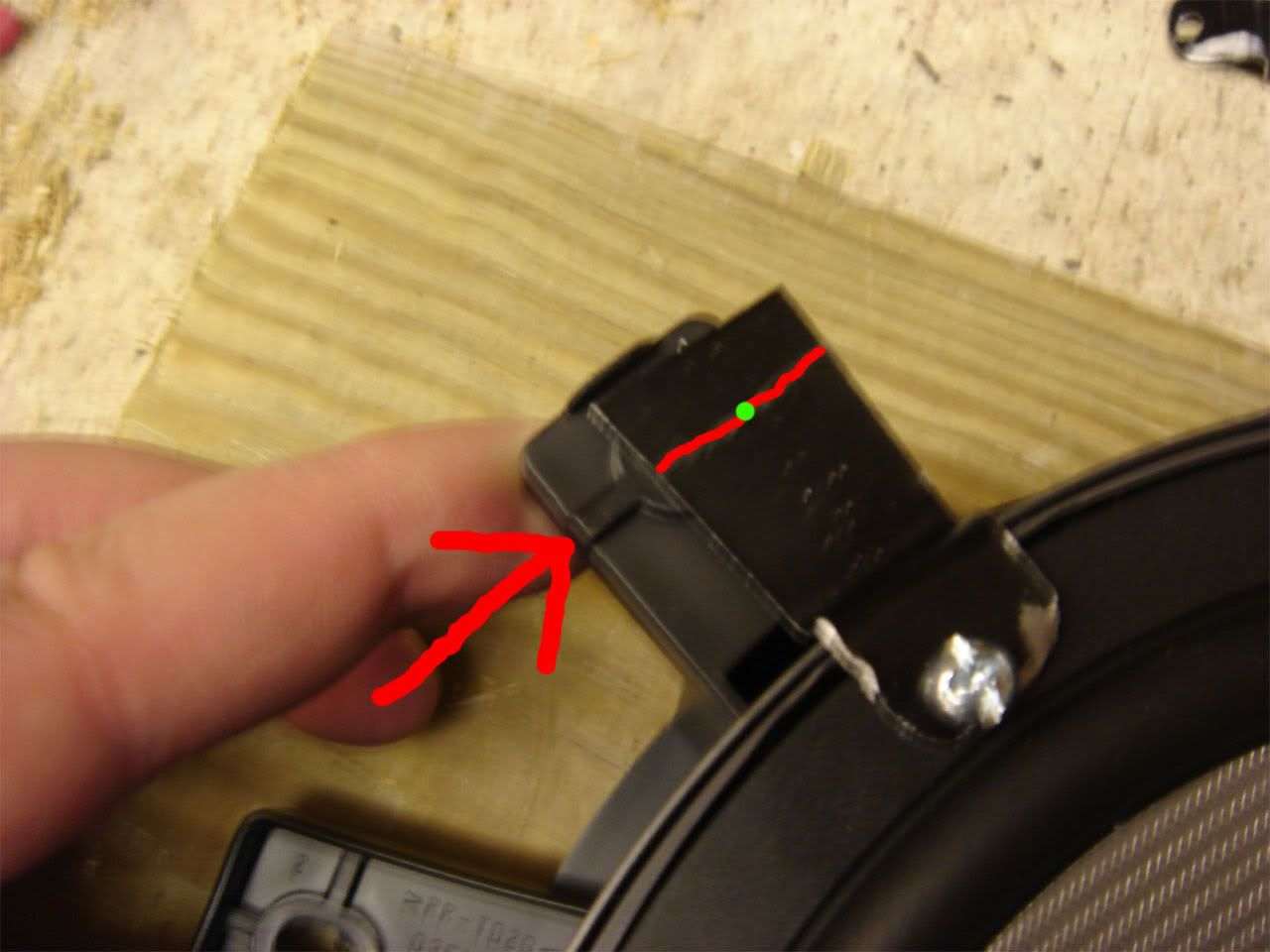

Now that you have the brackets bent correctly all that's left is to drill the second hole that will match up to the hole on the factory speaker bracket. Put them on the speakers again and set the speakers in the factory brackets. Notice that on the factory brackets there is a raised line going across it where the hole is. You want to draw a line on your bracket that matches that one, then drill in the center of that line. See the below picture if you're confused (drill where the green dot is, red line is where you should draw your line):

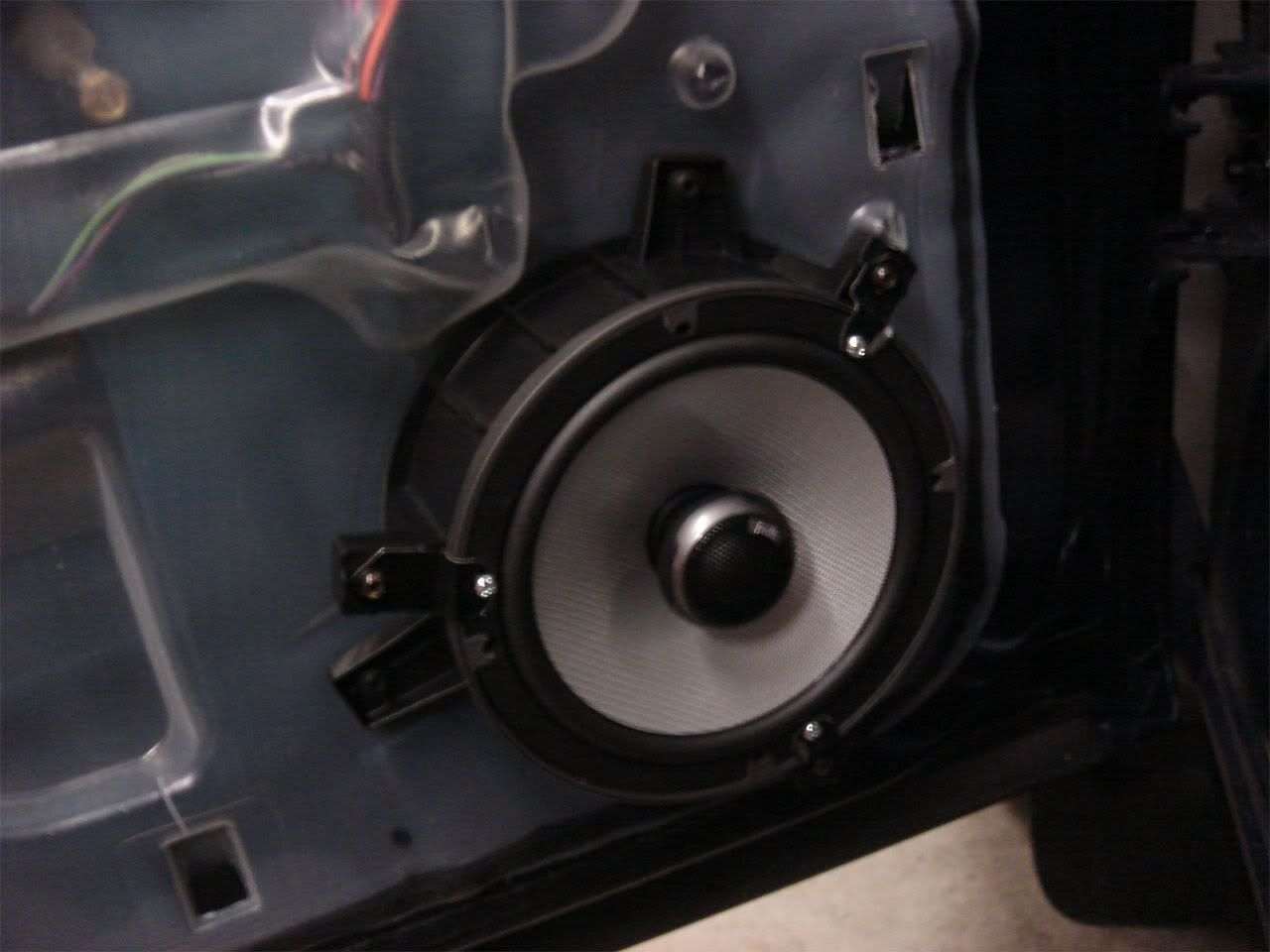

I recommend doing two of the three brackets for one speaker, then screwing them down temporarily and doing the third to ensure a good fit. When you have all of them drilled mount the brackets to the speakers using small bolts and a nut on the back, then place the speaker in the factory bracket. Don't forget to put the gaskets that came with your speakers in-between the speaker and the factory bracket. Now screw the brackets you made into the factory bracket using the screws you took out before.

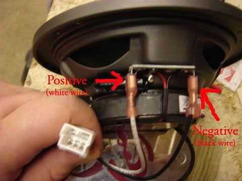

You can wire the speakers in one of two ways. You can either cut the factory plugs off, splice the wires and solder them to the speaker terminals or you can buy plugs from Best Buy or your local stereo shop that match the factory plugs and connect to your speakers. I chose to go the second route in case I need to put the factory speakers back in for any reason. Metra makes the connectors, part # is 72-6514:
My thanks to ericemery for the following info:
ORIGINAL: ericemery
good write up... I will add a little bit for those who dont want to buy the speaker adapter.
befor I get into it, I suggest soldering a new chunck on speaker wire onto the factory speaker wire to make them a little longer...
ok, cut the plug of the speaker, leaving yourself about an inch and a half to two inches of wire on the speaker plug, just in case you want to put them back in later, all you will have to do is cut the ne speaker wire off and solder these back on.
to find out the polarity of the speaker wire, you can check the service manual OR take a 9 volt battery and put the speaker wire to the + and - terminals on the battery. if the cone pops out, you have the right wires on the right terminals. (positive wire on the positive lead.)
now just solder your new speaker wire on, keeping in mind the positive wire should be red, or have red stripe... there you just saved a couple bucks.
The connectors are very simple, they already have terminals on them that slide right over the terminals on the speaker and lock on.
Now all you have to do is plug them into the factory wiring, screw the factory brackets back into the door (one of them has a little nub sticking out that matches the door, they only go on one way), put the panel back on and enjoy your new speakers!
