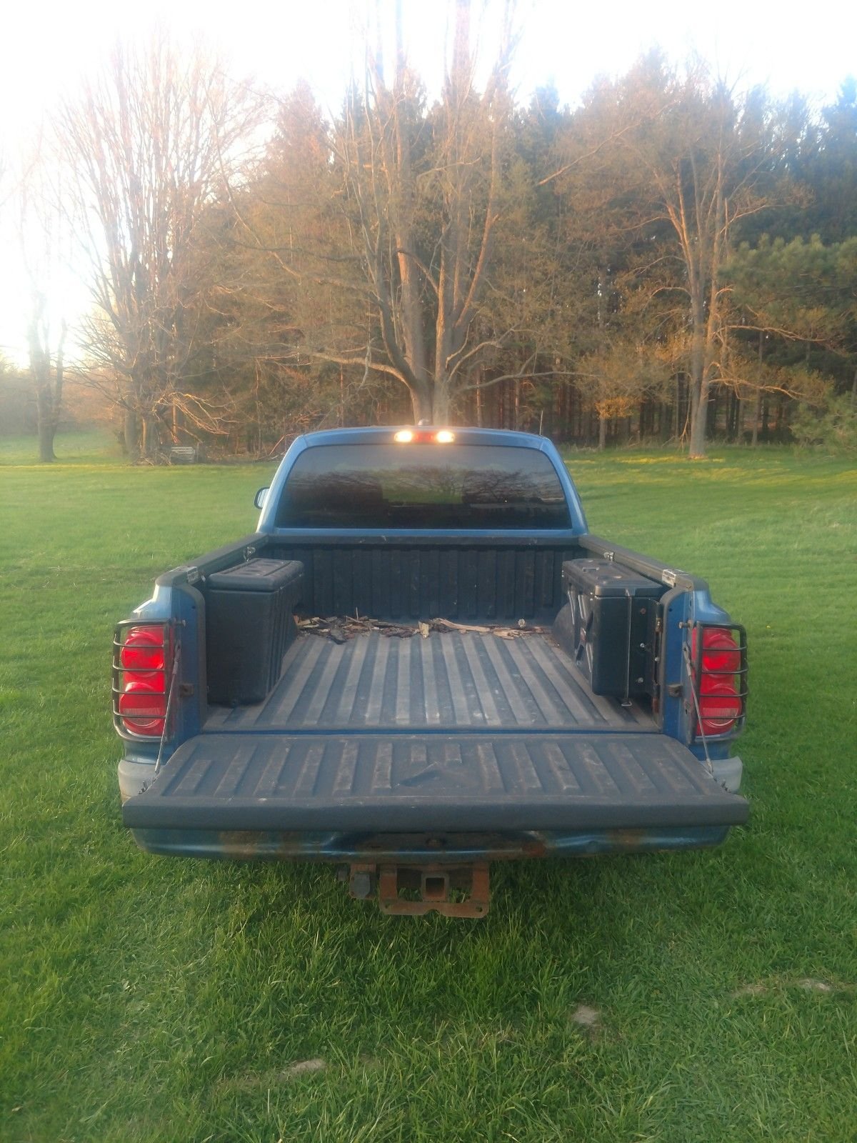

First up is the 3rd brake light. Honestly the brightness difference in the OEM housing for some reason isn't massive, they are brighter but if nothing else changed I'd say replace the halogen with LED whenever yours burns out. However, I did notice when my wife hit the brakes at the end of the driveway they activated MUCH faster than my halogen tail lights. So I'd recommend only replacing if you get a benefit from the extra second faster notification to your tailgaters, if you're more of a country road scene YMMV but technically LED helps your gas mileage by like 0.01% so yeah...
In full disclosure: the before photos are in a junkyard 2005 lens that I pulled from a yard which wasn't much better than my stock one & the after photos are in dakotaff's OEM lens I bought which are less cloudy as they have been in a box since July 2011. This let me do before and after photos just before sunset for decent light examples while allowing me to change them out quickly enough to avoid a big natural light change. This was more helpful for the 3rd brake light. The cargo's are a huge difference.
Before:
After:
Next up are the cargo's, wish I had done these years ago! MUCH better light output in the bed and far beyond.
Before:
After:
Also Amazon suggested
this this
new gasket & I went for it. I think it was worth it, the new one is at the bottom:

Gasket looks like it was a good call. Your truck looks like it has seen some living and working. Which spray-on bedliner did you get? It looks like it is holding up pretty well.
The cargo lamps are really bright! They look like they were definitely worth the money and effort. The taillights are brighter, but I don't know about the "instant on" being worth the money. I figure that if you're following me that closely, then you must be confident that you're ready to buy me a new truck when you hit me. The one caution I've seen for LED taillights is to ensure that there is a very distinct difference between the brightness of the running light and the brake light. That seems to be more important than how quickly the light comes on. So, on that note, how dramatic is the difference between the taillights just being on and when the brake peddle is pressed?
I don't know about brighter vanity lights. I like the dimmer lights because my night vision recovers faster when the vanity lights aren't too bright. But, I'm guessing the difference in the halogen and LED back-up lights will be similar to your cargo lights.
I don't think you'll save any MPG with LEDs. I have the V8 Magnum and I'm also in the mid-teens for MPG. My only advantage over the HO is that my Magnum uses 87 octane and still gets better hp and torque. I don't think the amperage draw on the halogens was enough to make much difference on the MPGs. So, reducing the draw for the LEDs is probably only a negligible effect on the MPG. Just a guess... To me, the LEDs are upgrades for brightness, or color in the case of headlights.

Oh yes it's been through a lot, built a barn, remodeled my old house, a few commercial construction sites, some roadside communication line repairs, several hunting trips & have towed a camper I had from 2013-2018 along with a small boat, my 12x16' flatbed trailer with short sides full of wood way too many times to count & once my the old Pontiac we just traded in due to flat not far from Tire shop on the highway (was safer to just load it up and tow it ~10 miles & let them warranty fix the tire for free.) plus rental bobcat's & tree chippers. Oh yea then there was the time I towed my father in-law's ranger back from Oklahoma... Anyway LineX is what I got in 2011, over my passenger wheel it's helping the rust hold hands or I'd have an unwanted vent. The white spots are where the aluminum rack mount points were for years, I took that off (2018?) after I moved to the new place after I got the trailer since I have a place to park one now. Here is the thread I did that shows when I got those installed.
I only changed out the top/3rd brake bulb, the tails only look brighter since it was darker outside and I think I was standing closer? I donno maybe I pushed the brick harder the second time...
The 3rd light is off until you press the brake so besides faster it is a brighter difference but it wasn't much brighter in my case for some reason.
The manufactures are starting to go LED to help meet the more stringent MPG requirements but it's not like they will pay for themselves, it will just help a sprinkle if you like the other reasons to do it.
