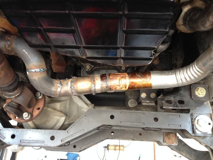

finally took it in to get the exuast modified properly, with the jmr lift had to use a flex pipe as drive shaft is in the way.

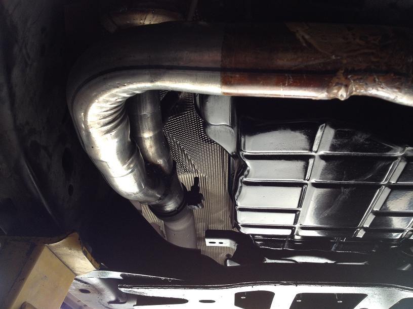

the rest of it.
