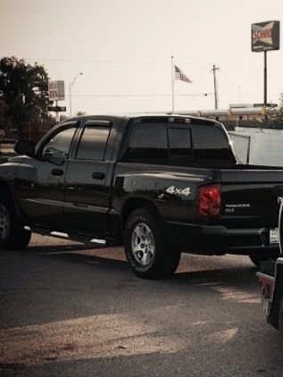

Heres a pic when i first got her, ill post more along the way when i fix her up.
No worries its cool. I started looking and there is alot of stuff on here. But yeah ill keep it at 2" level and 3" body lift. Ive seen some pics and looks sweet at that hieght.
