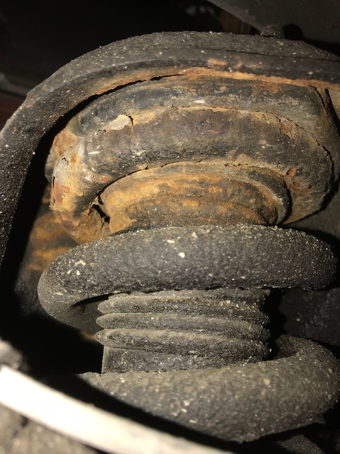

I snapped a couple pictures at the top of the coil spring. I was hoping to get some opinions on the rust present and whether or not this would require new coils altogether. If the springs are stiill going to function then no sweat, put my mind at ease. But I just don't want to install new struts with old springs which would bottleneck the suspension improvement I am after.

Here in Canuckistan, if you don't have rust like that, it has been sitting in a climate-controlled environment since it was winched off the delivery truck. Get in there with a pressure washer and see how it cleans up. I imagine that a lot of what you see is crud and dirt with corrosion products mixed in.
