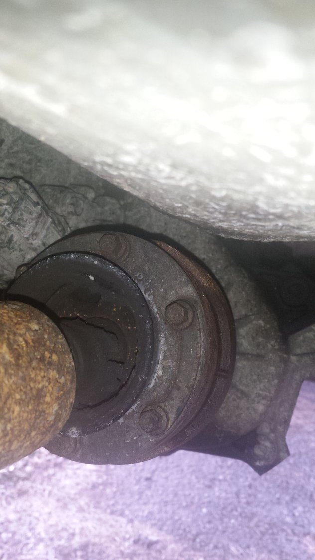

​​​​​​​ aside from all of that, I have a real grinding metal on metal sound that intermittently happens from under bath, I was thinking a cv joint, but everything "looks" ok. I did find this where the front shaft goes into the transfer case.... It may be the way it's made, but something seems off to me... Can anyone tell me if this looks normal where the front shaft connects to the transfer case? Thanks guys!

Think I would try turning things by hand, and see if you can feel anything.....
Shaft looks typical. Grab and shake it. See how it feels.

No, that is not normal. That is a CV and it is definitely toast. Dorman makes kits for repairing/replacing the CV end without having to buy a whole new shaft. I just did mine recently, here are a few pictures of the kit and job done here. There are a couple of youtube videos on how to do it.
This kit for mine was 932-303. Use the Dorman site to verify which is the correct part number for your year truck. I purchased it off of Amazon for a much better deal than any of the autoparts stores were able to offer me.

Thank you for the info! I had never really paid attention, but I knew something didn't look right.

Worked like a charm, thanks for the help. After doing that, a water pump and fighting a new power steering pump... hopefully she's good to go for a day or two!
