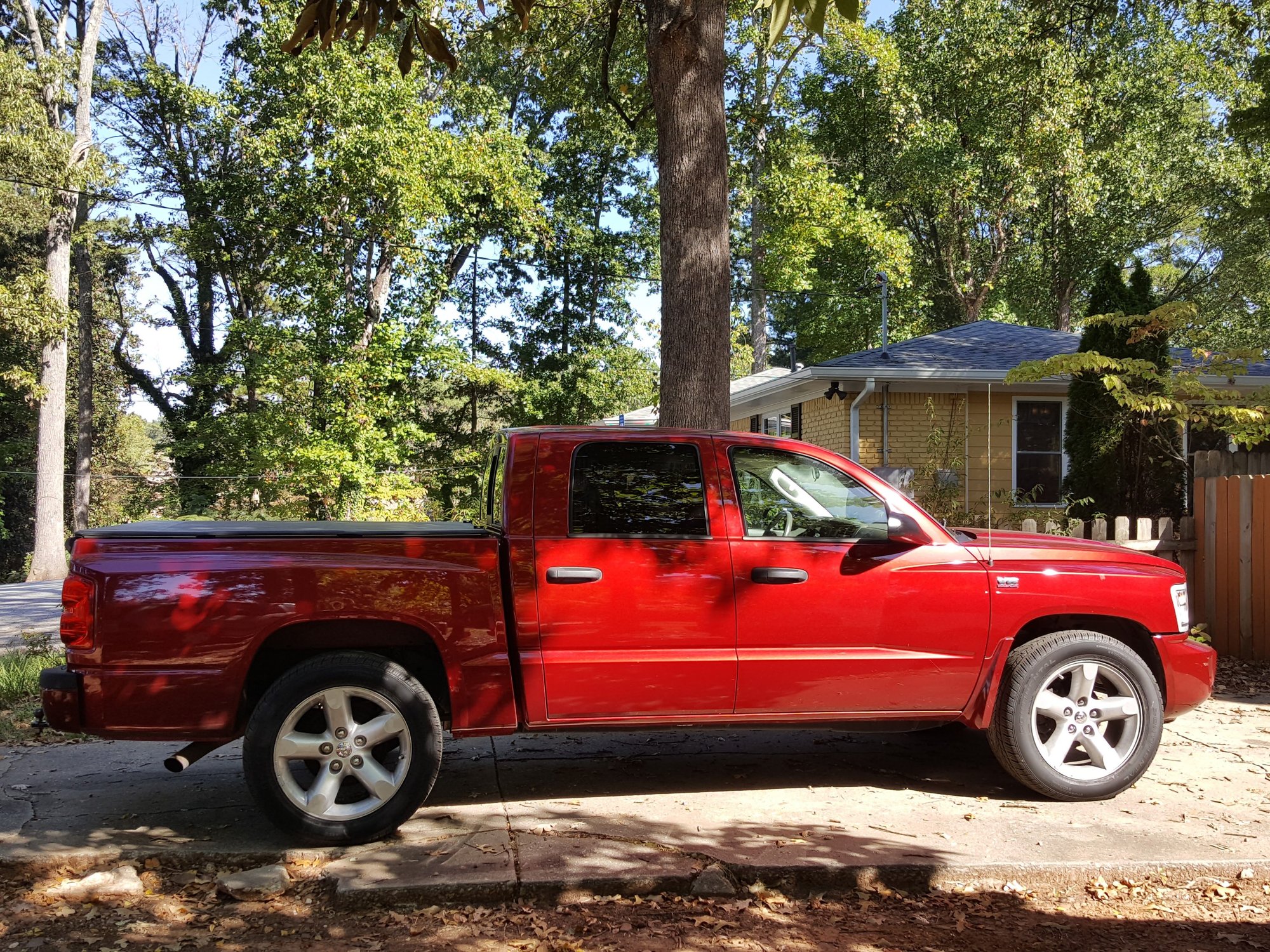

I'm running OEM 20" off a Ram 1500 with 285-50r20 tires
