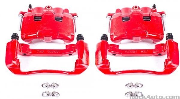

I'm hoping my new power stop calipers (S5008) arrive tomorrow ... Also purchased 2 hydraulic hoses just to be sure ... However my luck it will prolly be a hard line from the block, they were looking kind of crusty.
