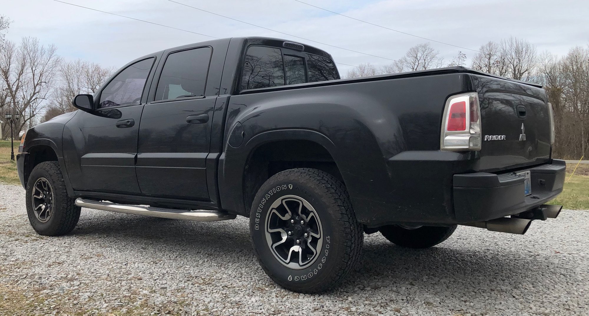

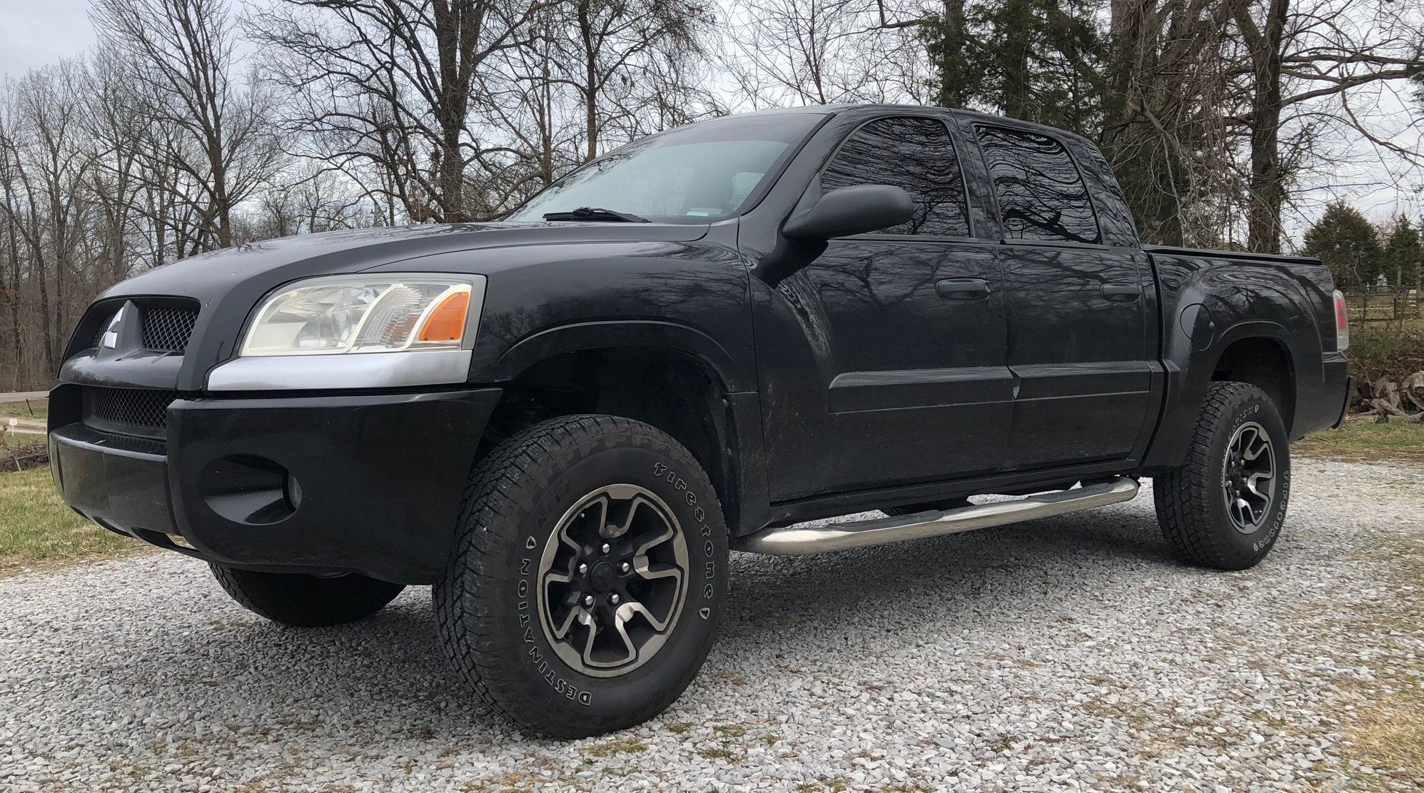

Hey guys. I had installed an add a leaf in the rear due to sagging springs and to level out the rear. Once I did this, it gave the rear about a 3" lift, even thought it was suppose to be a 1.5"-2". I drove with the racked look for a while, but then decided I would do a 2" strut lift to not have so much rake. I ordered a 2" strut lift off ebay, only to find that once I dropped the truck, they had sent me a 3" life. Did a quick internet search to confirm this. A 2" lift should have only had a 1" spacer, but the ones I received measured at 1.5". I wish I had did this search before installing. Anyway, during the install I was wondering why I was having such an issue getting the 2" spacers installed and this explained it. It was a total nightmare trying to get everything aligned. I could tell that this kit was really pushing the limits of my balljoints and control arms. So now my truck is pretty well level, but I'm afraid that the 3" spacers will weak havoc on my front end. What do you guys think? Should I go to the 2" spacers that I should have got, or leave it as is? I did want to mention that I really loved the add a leaf. It brought the suspension back to life and firmed up my ride and made it handle better and sportier. I would totally recommend if you have sagging springs to do an add a left. I really can't say enough about it. Here's some pics of my truck now, please let me know what you think. My profile pic is without the add a leave. I wish that I had taken a pic before with just the add a leaf. Now, I'm really concerned about the hyper extension of the front in parts and possible issues in the future. My truck is a 4x2. Let me know what you think. Thanks.

Yes. It will destroy your front end. Sooner or later depending on how much flexing you do.

Yeah it's going to prematurely wear out the front suspension, You'll need fab or find a transfercase lowering cross member, Seems to be a lot of people lifting only to find out these issues. Nice stance though +1. I like those rebel wheels I think they might look good on my truck, I was going to get some night runners and black out some features on my Flame Red 2006 Dakota R/T. The purists might rap my knuckles though ... lol
Thanks. I do like the way it looks leveled, but if it's not functional, what's the use. The Rebel wheels would be a good contrast on you red R/T. I got lucky and scored these for $200. I don't think I need the cross member. My truck is a 4x2. I'm going to ride it like this for the next week, but will probably go with to the 2" in the end. I just hate to have to redo everything once again. What a pain!
