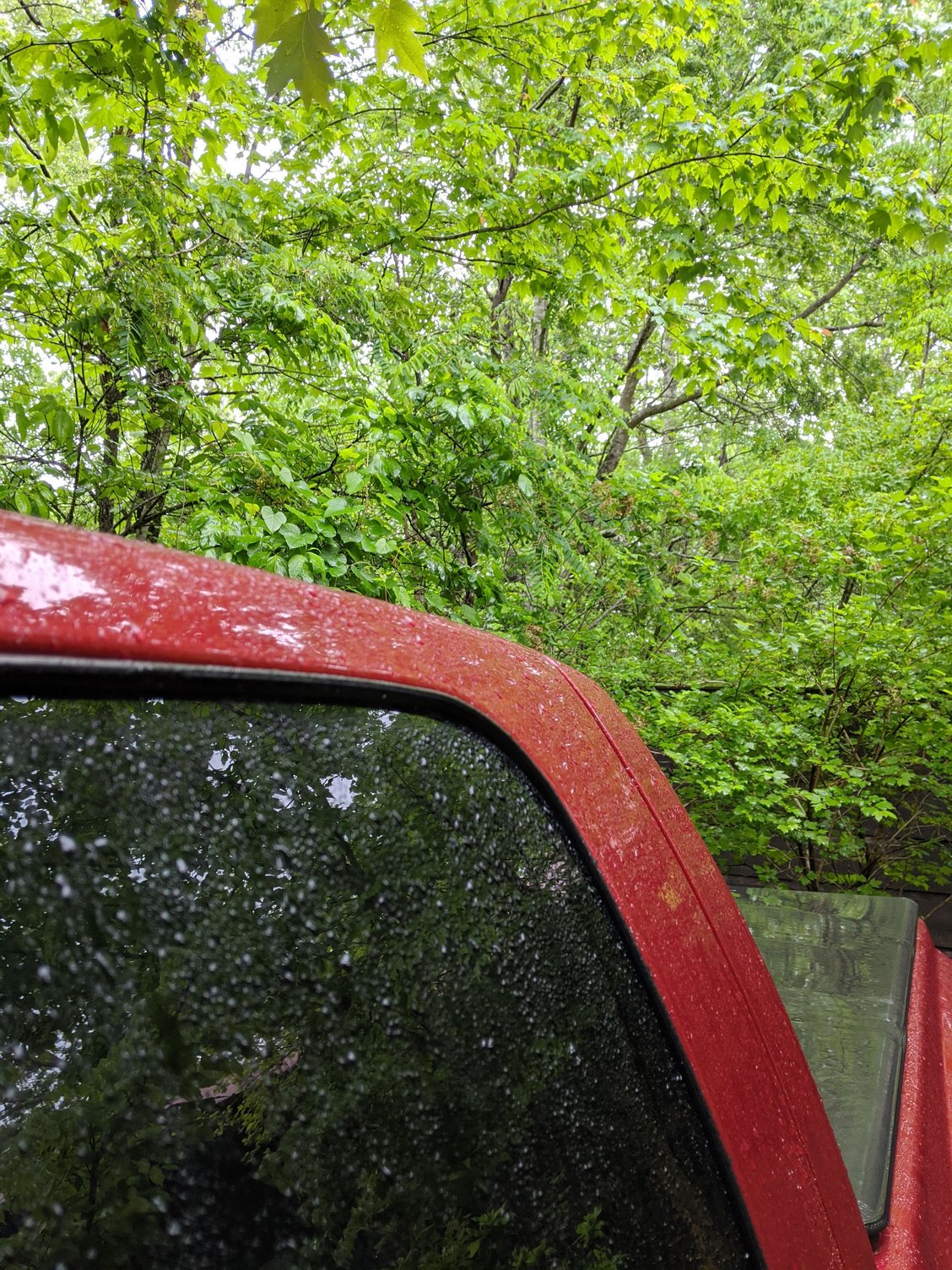

I blew out the gap between the windshield and top edge of the cab with compressed air, wiped the edges of both the glass and paint down with carb cleaner, ran blue painters tape right along the painted edge, then filled the gap with a exterior black 100% silicone caulk. Then I used a piece of cardboard and wiped the surface smooth and flat. It actually came out pretty nice looking. Almost looks factory. Damn better stop the leak. I'll post a pic after it dries and I skim the glass with a razor blade to get the excess off there.
