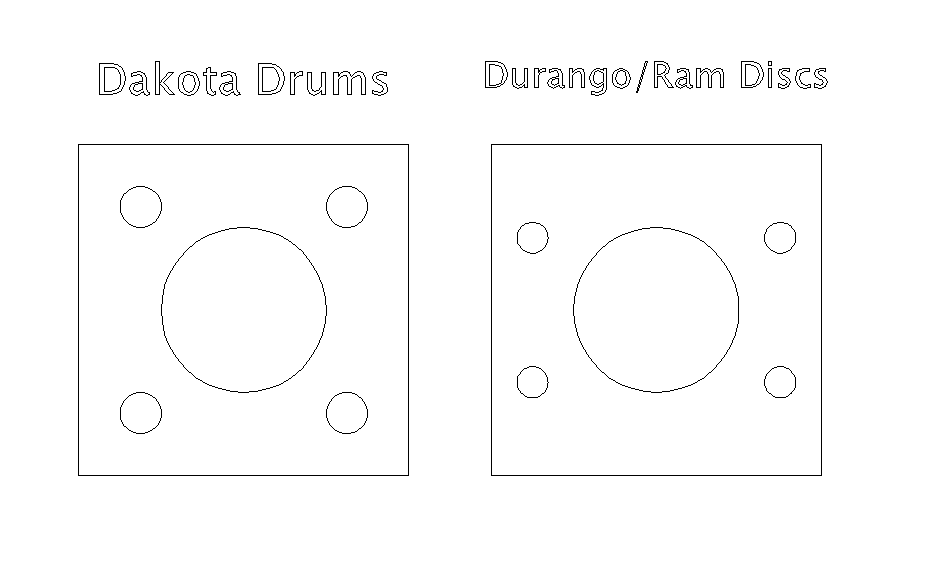

As far as compatible parts go, the list is very short. The 9.25 rear end is made with a bunch of different track widths, so only the Dakota will fit on a Dakota since the Durango using independent rear suspension. The Durango uses the same disc hardware as the ram, but the bolt pattern on the axle housing is different between the disc and drum brakes, so again, will not fit. The next issue would be with the proportional valve inside the master brake cylinder. I'm using a mbc from a durango with discs and will make it work somehow - will need a reservoir from Durango and flexible brake lines as the ports are on the other side of the cylinder. With some drilling or welding I plan on making the rear backing plate work and will provide a how-to if I ever get the time. Interesting thing I found was that the discs on the rear are larger than the front.
