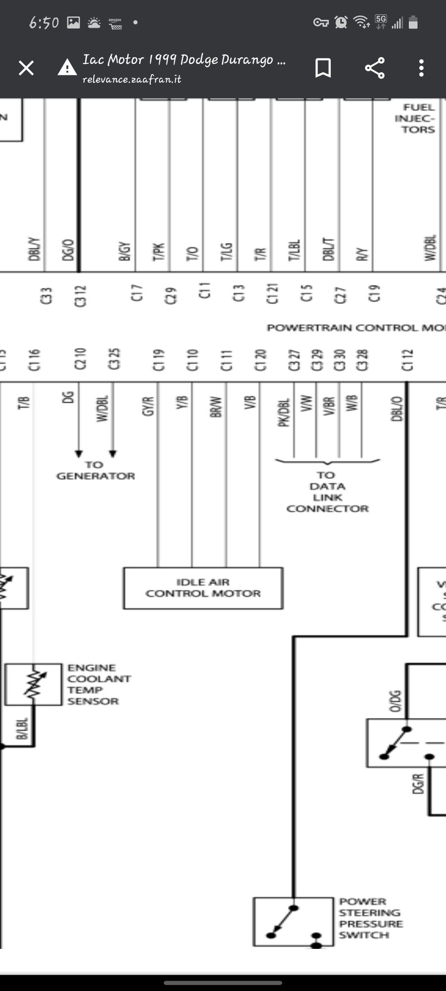

What do you think? Which wires get grouped together?

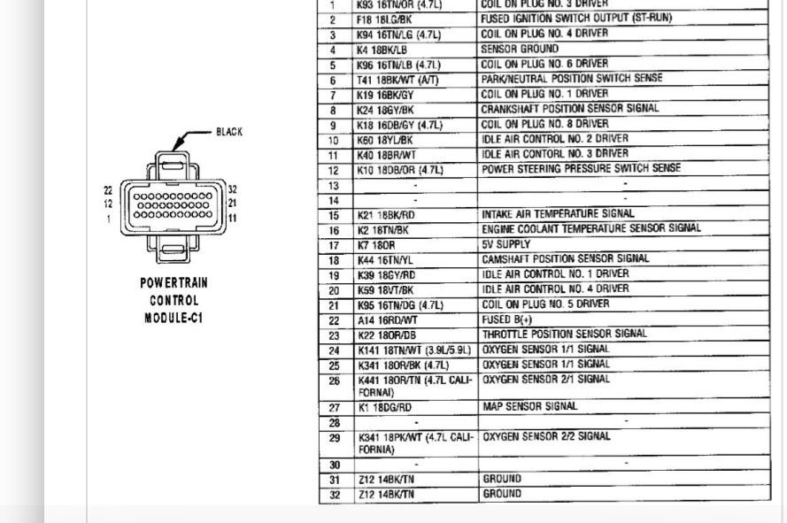

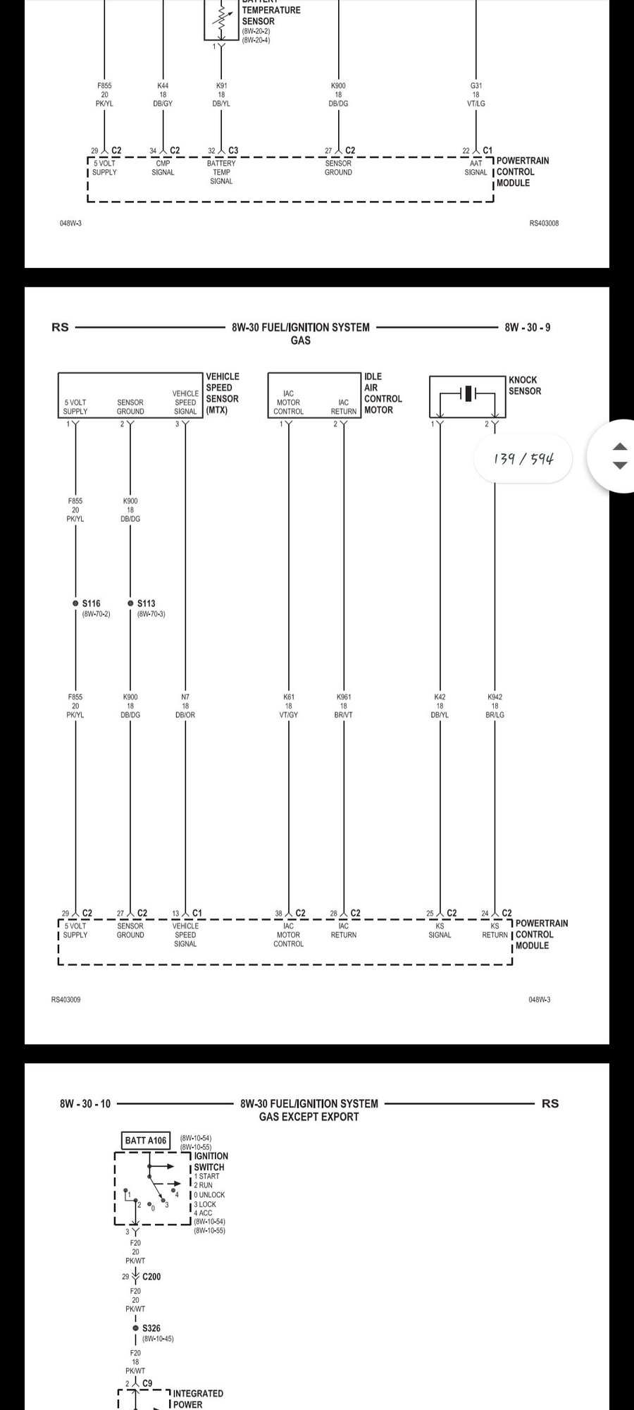

On the four wire version, I believe there are two circuits that move the pintle. I *think* one set is to move it in, and the other is to move it out. (just a pair of DC electric motors) PCM applies voltage to both motors to lock it in place......(and I think actually controls the grounds to move the pintle....) On the two wire, I suspect the PCM just reverses the polarity on the wires to move the pintle in/out..... Splitting the two wires into four, you are going to have power on both circuits whenever the PCM decides to move the pintle though.... and I am unsure if the four wire IAC will be real friendly with that....... Maybe use the two wires to control a pair of relays? Use the relays to control the IAC? Would likely have to experiment a bit to get it right...... Wiring diagrams simply don't give enough information to make a real declaration. Maybe test the pins with a volt meter? Test resistance across the pins, see if you can determine which circuits are which?
