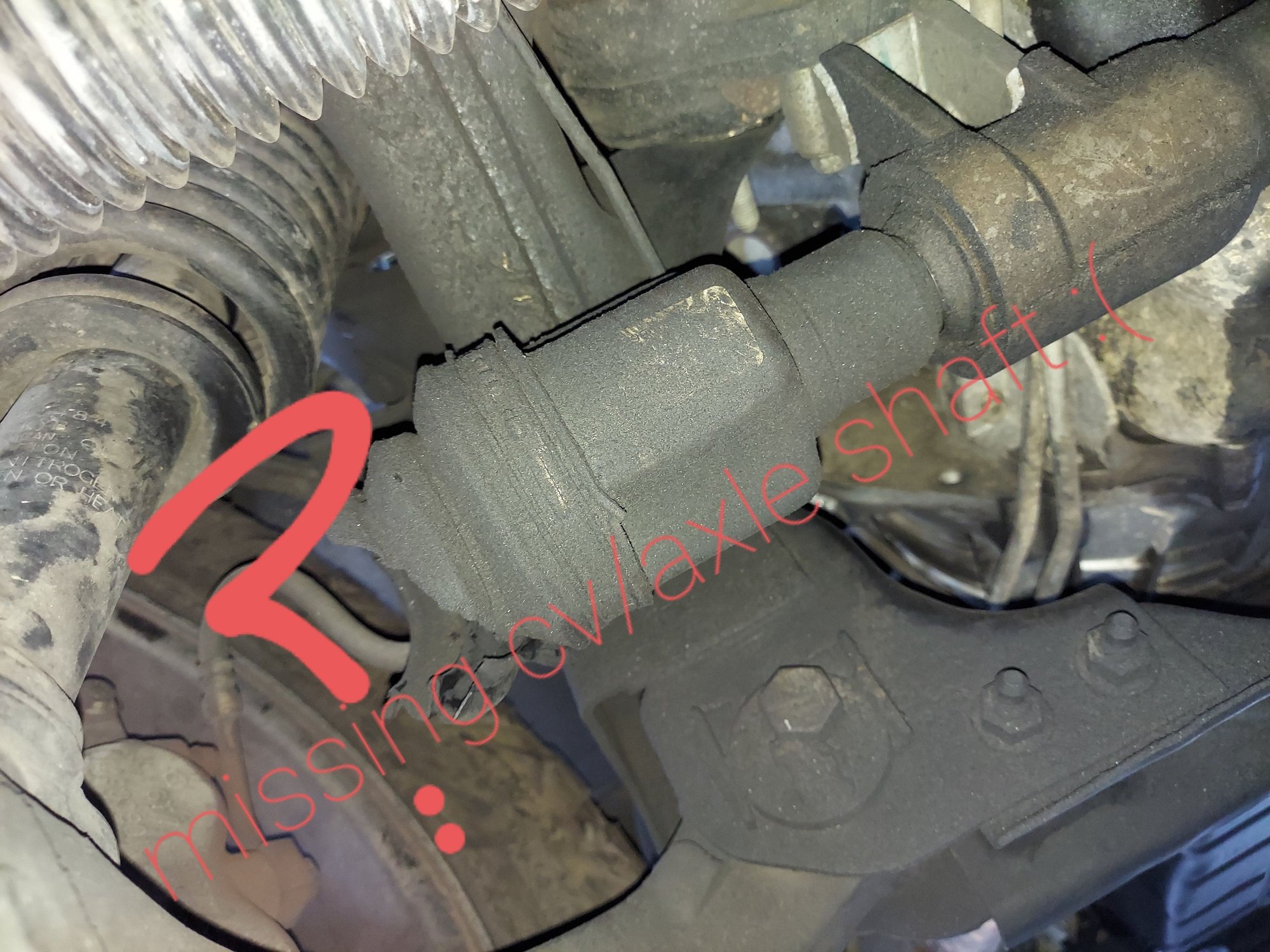

So here's a little back story I bought this truck a few months back guybwanted 6k I ended up taking home for $2700 or something. I was aware of the missing cv axle shaft and it had a check engine light. I've since fixed the misfire and now she runs great. Except today I go crawl under her and much to my dismay see this broken dif mount I can't say for sure it was like this when I bought it or not. ( I saw the truck in the night and couldnt see much under it.. obviously that was a mistake) I've been daily driving this thing for several months now and don't intend to stop necessarily. So my question is can I simply unbolt the dif all the way to the transfer case and get rid of it, eventually do a s.a.s. or at worst replace the crappy i.f.s. but essentially just do away withbthe 4x4 until further notice?

Pretty clear that it has been ridden hard and put away wet. I would suggest that the broken mount and the "missing" (read thrashed) cv shaft happened at the same time. Get your build sheet to find your gear ratio and find a junker with the same front axle. Presto, back on the road, with a weekend's work.

Stub shafts need to stay in the hub/bearings. (outer cv joints.) That is what holds them together after all. Aside from that, I would just leave it all in place, worry about it when you have the correct parts.

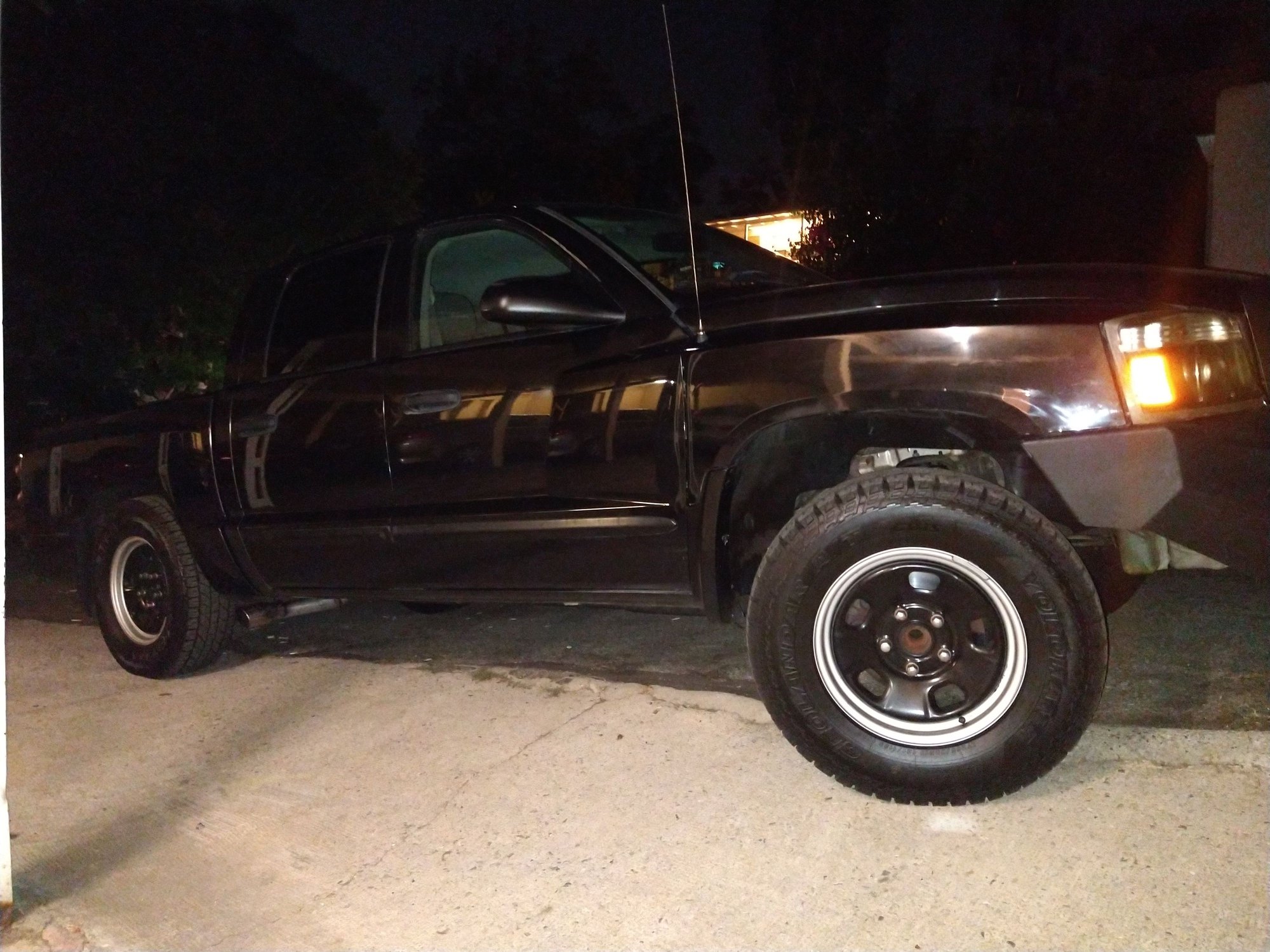

The passenger side outer cv. heres a good picture you can totally see through the wheel center (where the cv stub shaft should be)😀 and I've been driving it everyday. Is my caliper the only thing holding that **** on?

The outer CV usually holds the bearing together. I would be doing something about that right quick, as losing a tire at any kind of speed is far too exciting for my tastes. Yours might be a better design, but, I wouldn't bet my life on it.

Would a bolt through the middle of the hub act as the axle shaft im missing 🤔 not permanently but for a short time until I aquire parts?

I don't think so. I think part of the cv joint acts as a stop of some flavor..... might just grab an outer joint from the junkyard, or some such.
