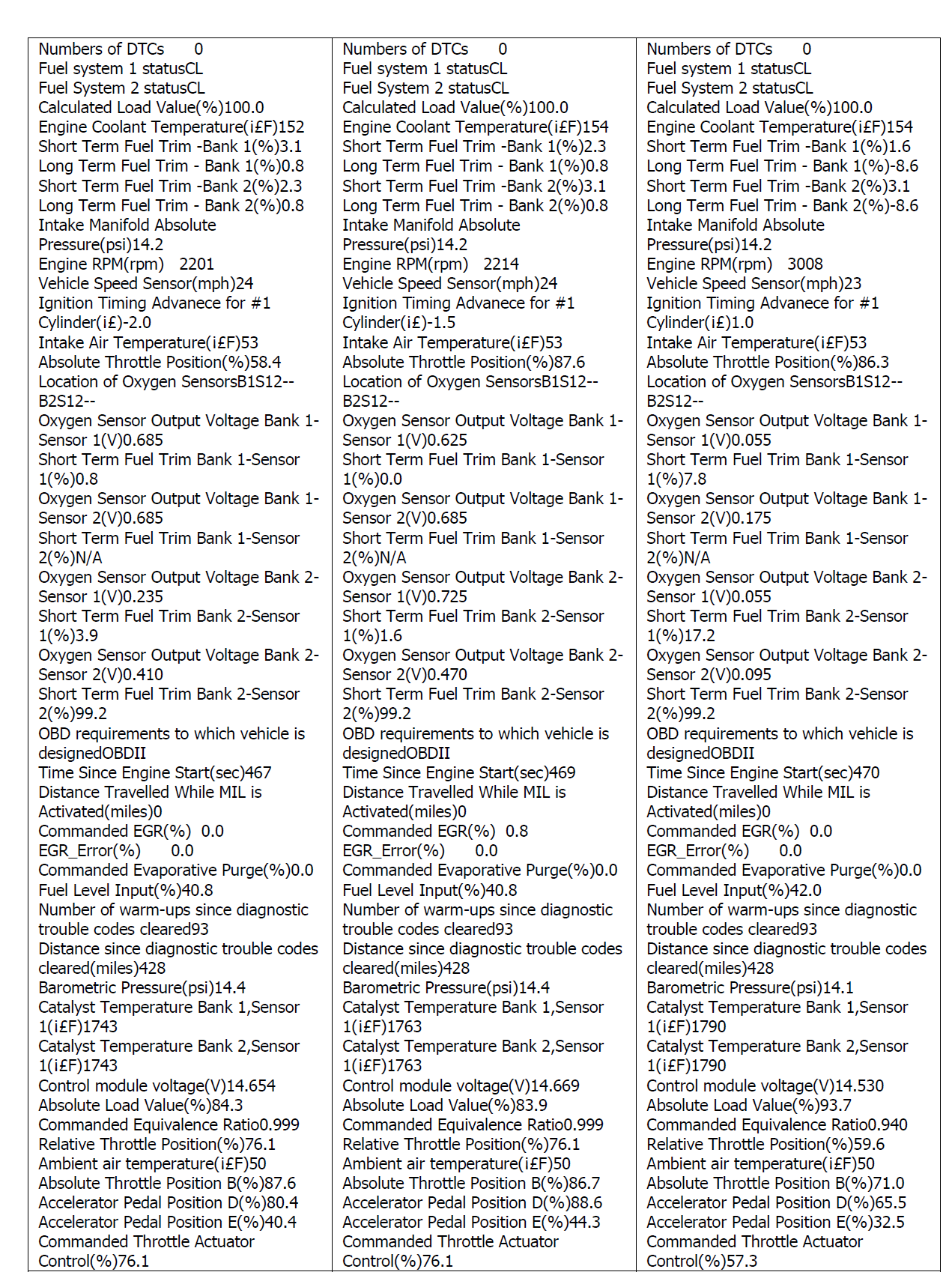

I never took my injectors out to look at them so I don't know how dirty they are. I did do a TPS a sweep and there is no dead spots in that. I droved and recorded my live data to see fuel trims when the truck started losing performance while driving. The whole recording was 28 frames, and the truck remained sluggish from frames 1 through 14 and then went into Open Loop drive at which point the truck regained all its power. Below is the 3 second time frame of data right before the truck started to gain power.

Interesting. Frames 1 and 2 look pretty similar but the 3rd frame shows a drop in voltage from the O2 sensors, which force a massively rich mixture. Odd, that the top fuel trims are different from the bottom fuel trims. I know you tested your fuel pressure - what's your leakdown like? Only ask cuz I checked mine today and think I might having a leaking injector.
... side note, just noticed that RPM went from 2200 to 3000, and throttle position closed?
I noticed that myself. I’m starting to suspect that I might have an ECU problem. Cause nothing else makes sense. Especially without a code being thrown. As far as the leak down goes I don’t remember what my leak down was, I just remembered I was at the right pressure But I can try and throw a gauge back on my fuel rail this weekend and see what the leak down is after it’s pressurized.
