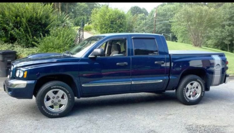

You can add 1.5” helper springs or blocks in the rear to level it back up. This is mine with 2” spacers and 1.5” helper springs.

Adding a 1.5" leveling kit will let your truck sit level, and the extra 1/2 inch with a 2" kit doesn't allow for any bigger tire than the 1.5" kit.
1.5" Trailmaster leveling kit, and a stock rear.
