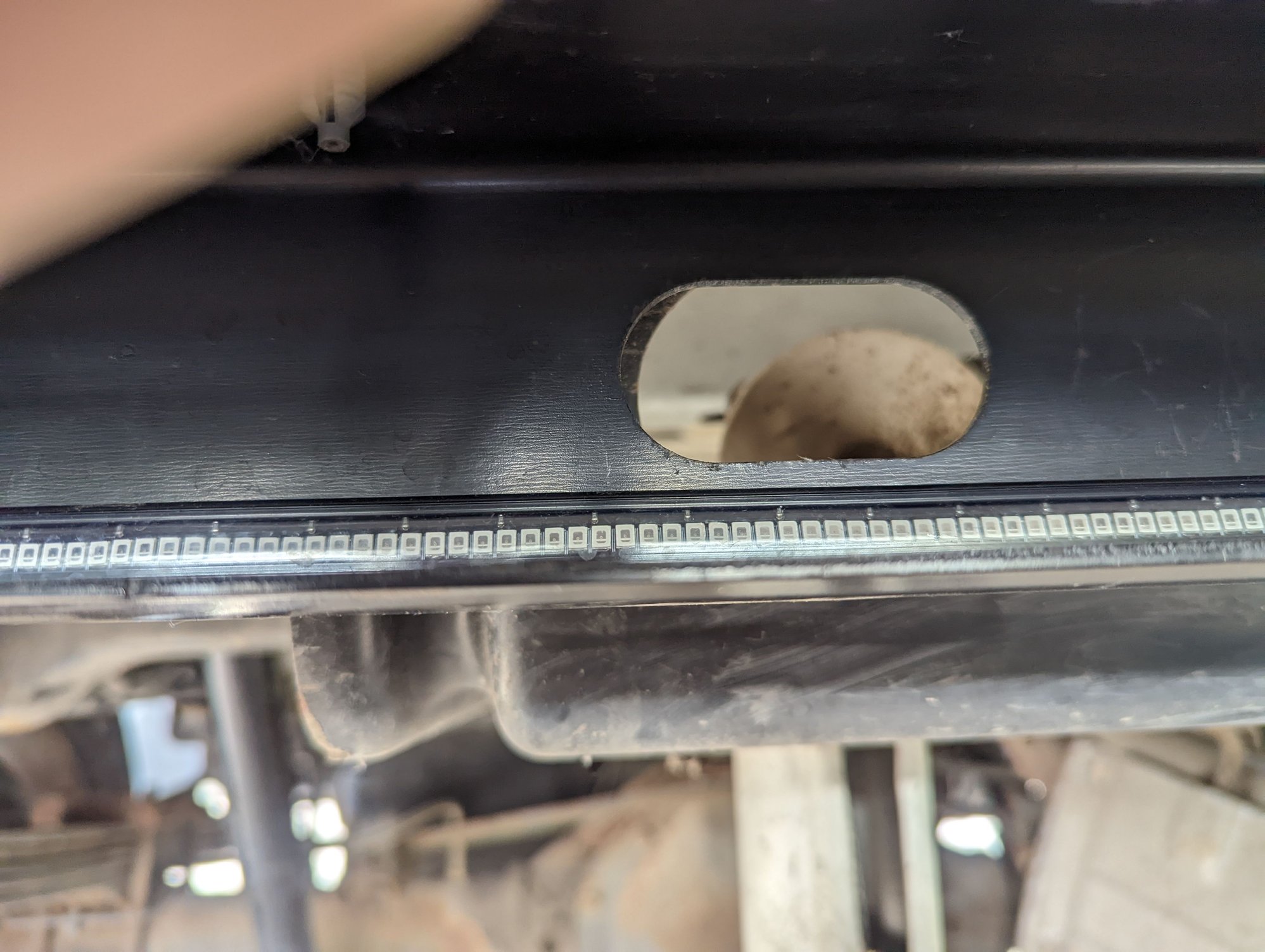

Hard to get pics of the strip itself due to the way I mounted it. It's a 30 inch LED tail light strip. Offroadtown brand. Designed for side by sides and dune buggies etc. I went this route b/c I couldn't find a spot on the Dakota to mount a full size truck strip where it wasn't readily visible. I believe LED strips should only be seen when they light up.
It's tucked behind the bumper on the rear most frame cross member. I mounted it as low as possible so the light would be visible through the gap between the tailgate and bumper.
I will be wiring it up here in a few. The 30" length is perfect for the mounting position I chose.
