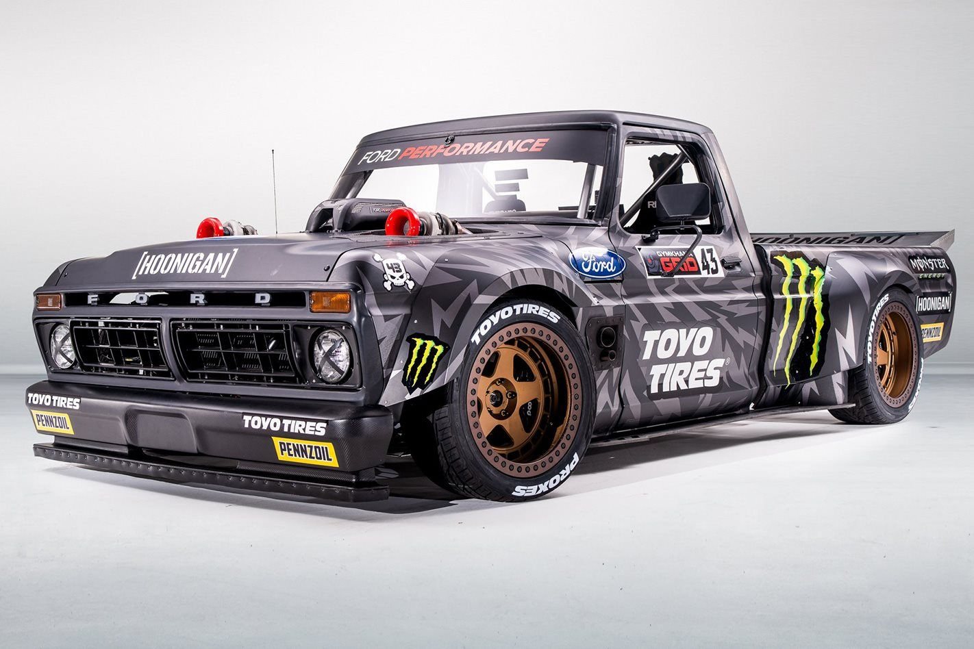

Ya'll really saying you wouldn't enjoy the heck out of something like this? It's 4WD after all. Ya'll forgot about trucks like the GMC Cyclone too?
The cyclone and typhoon didn't have that much of a drop compared to their normal cousins, but the suspension components were designed for it. and that hoonigan was designed from the ground up with a chassis and suspension to be that ride height.
using the stock a arms and control arm up front with that radical of a drop is asking or issues with the ball joints, plus, the as i mentioned before, it looks like you'll only have an inch or so of compression on those modified struts
