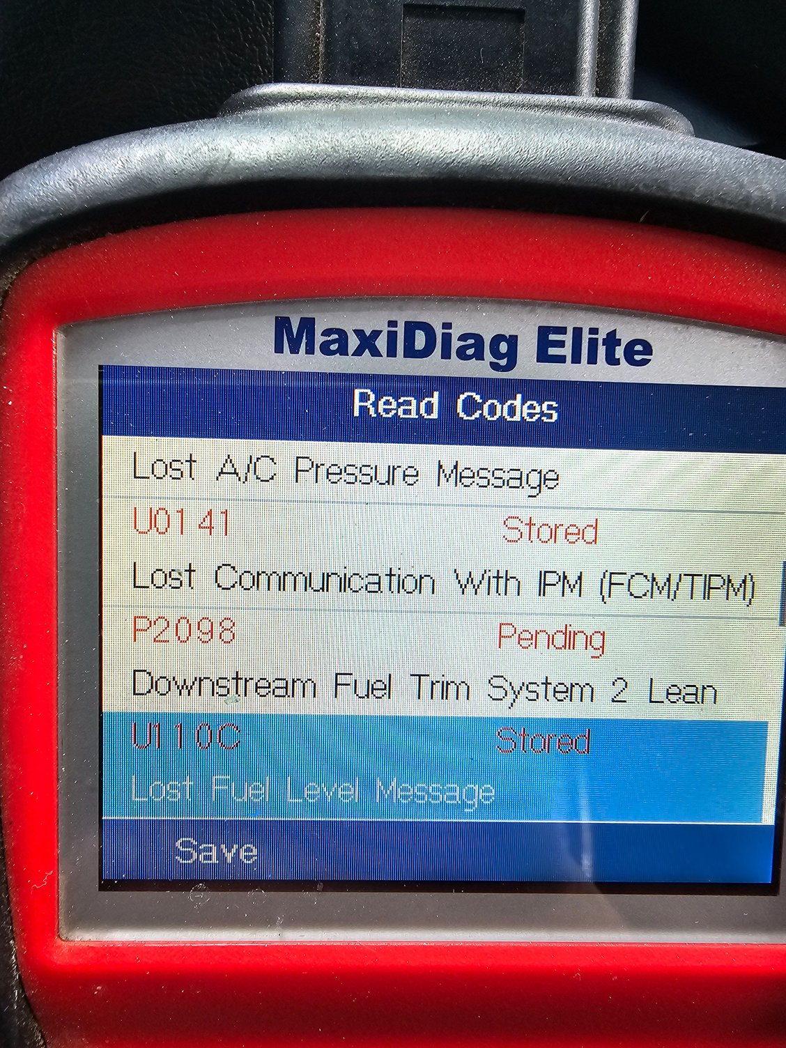

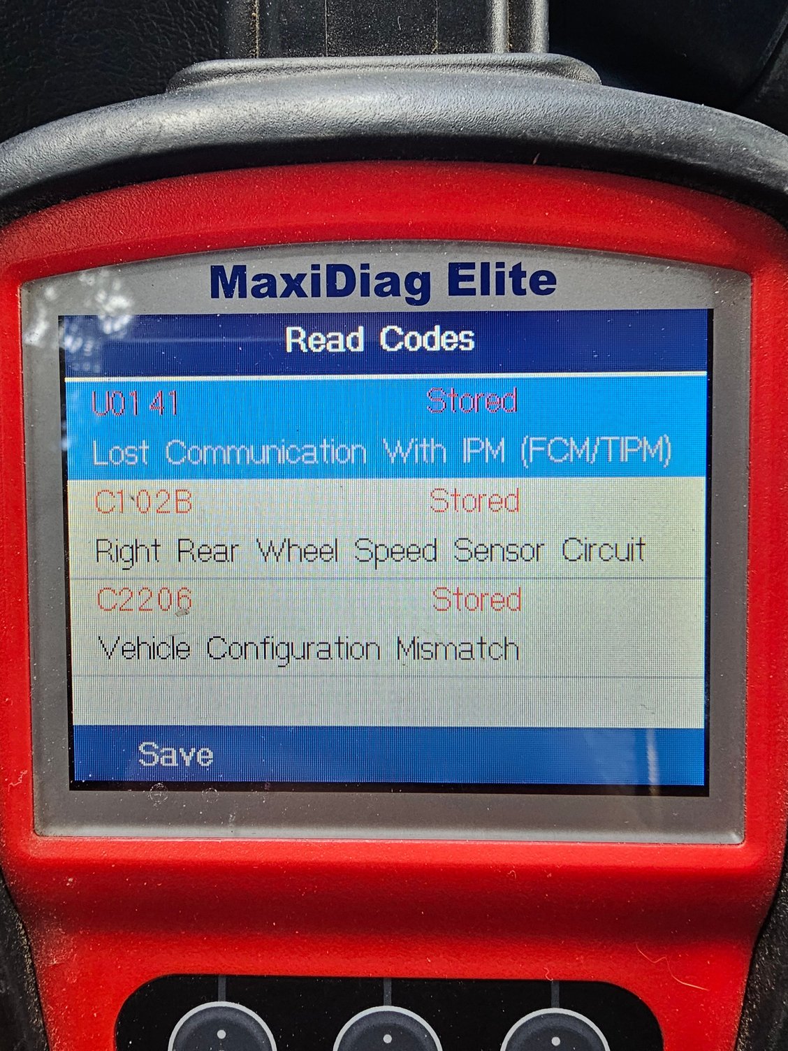

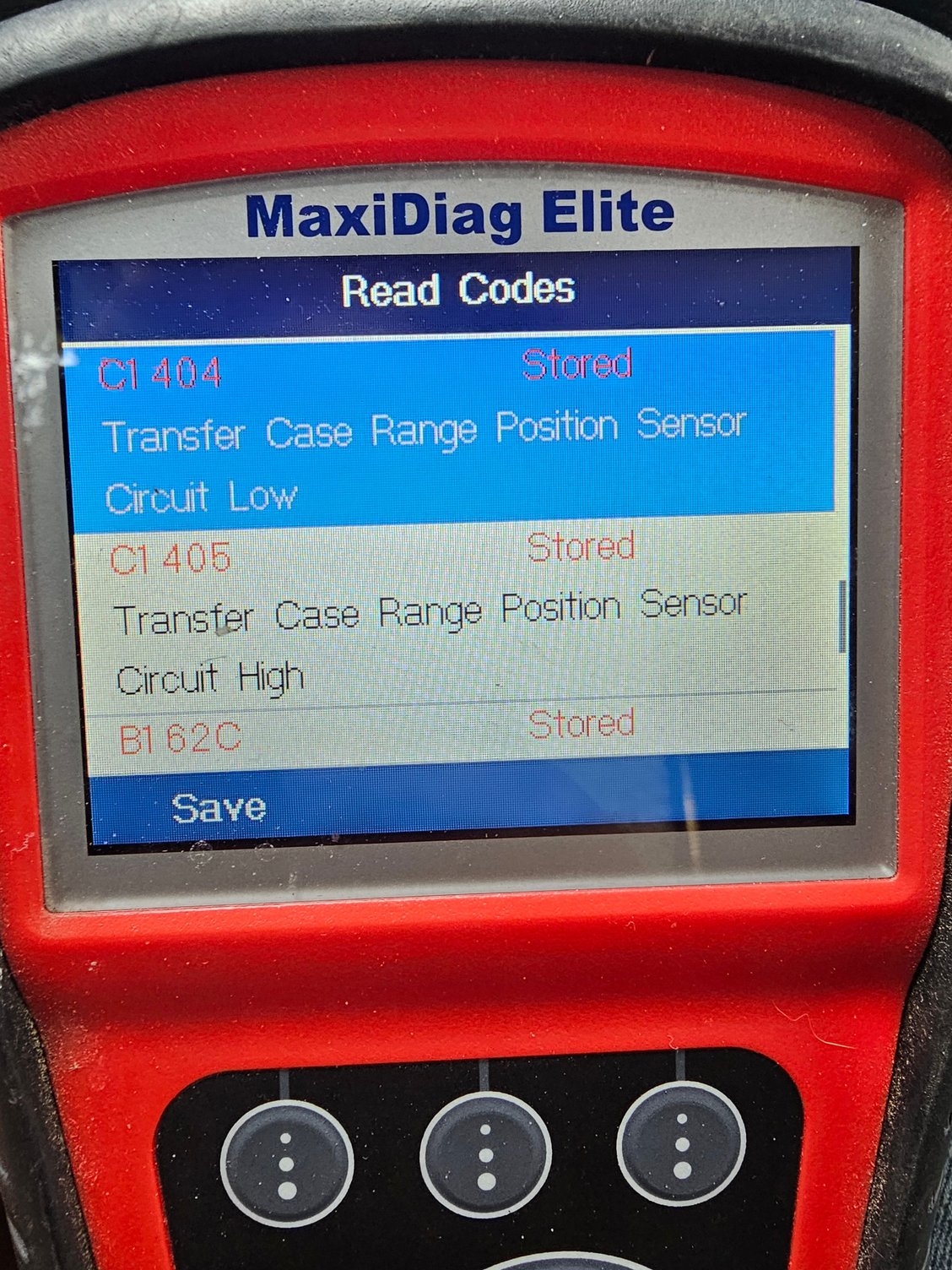

Not sure how many of them are caused by the testing that i was doing, but some of them seem relevant to my issues, im going to clear them and drive it for a while without running any more tests and see which ones come back
