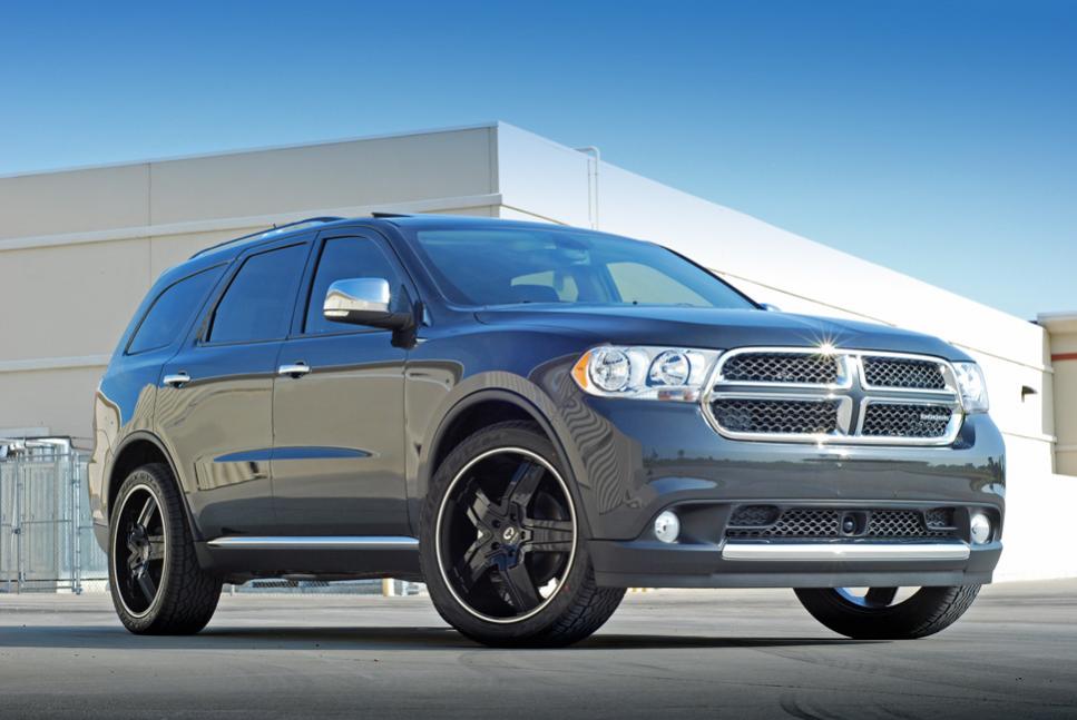

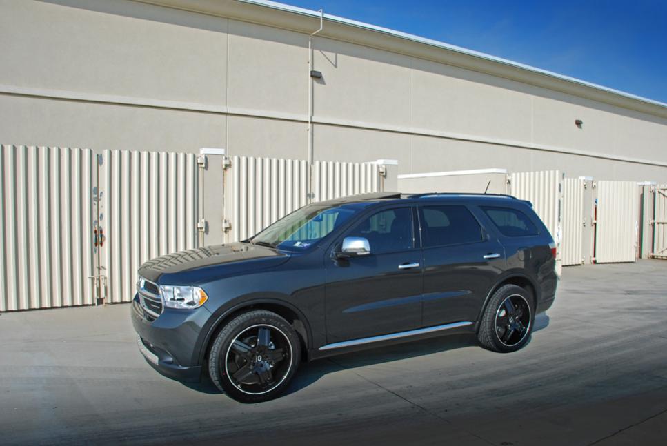

Just wanted to share with those interested in 22" wheels for their Durango! Still rides nice and looks much better.

Thanks for sharing, well I happen to been browsing online this morning looking for 22" wheels for the Durango and wondering how it would look on the D. It was good timing to see yours which you just posted....looks great! I think 22s is just the right size and proportion that I'm looking for and fills the wheel well nicely. There was a post here which shows 24s on the D which imo is just overkill.

They do look nice, but of course even with 22's, potholes start to become a bigger hazard. I've replaced too many tires to be getting anything larger than the standard 20's.

what size tire did you go with? Any rubbing?

My tires are 285/40/22 on a 22x9" wheel. The wheels were double & triple checked for rubbing and there is plenty of room.

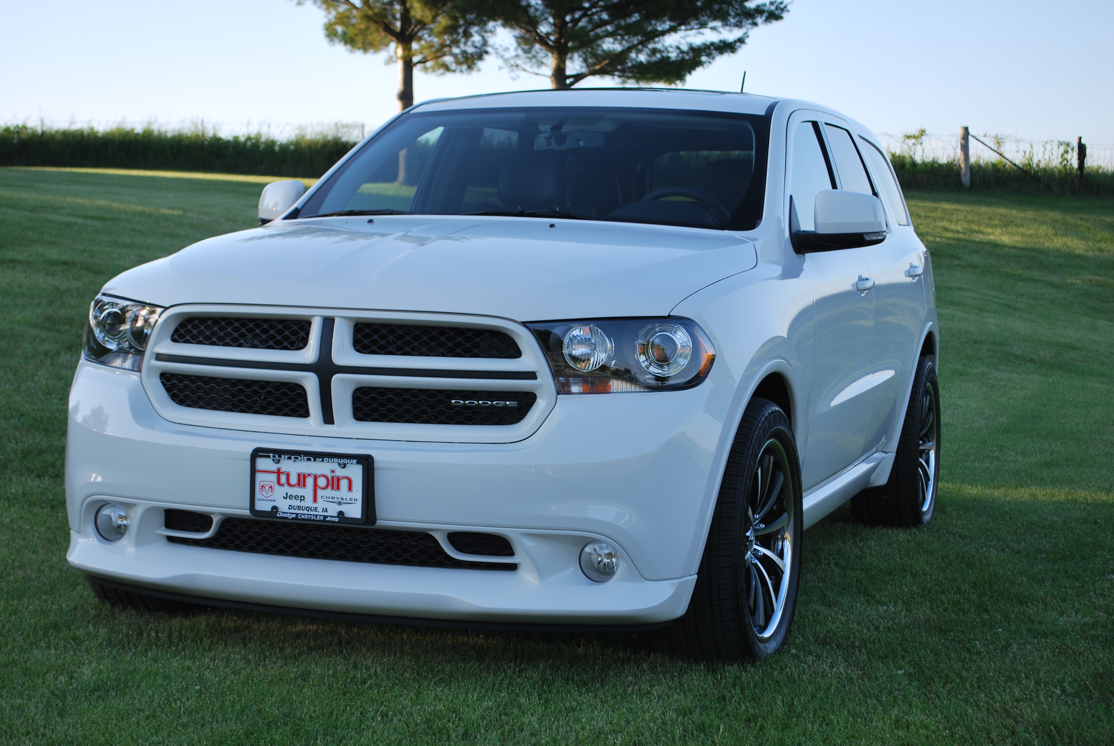

20 for me

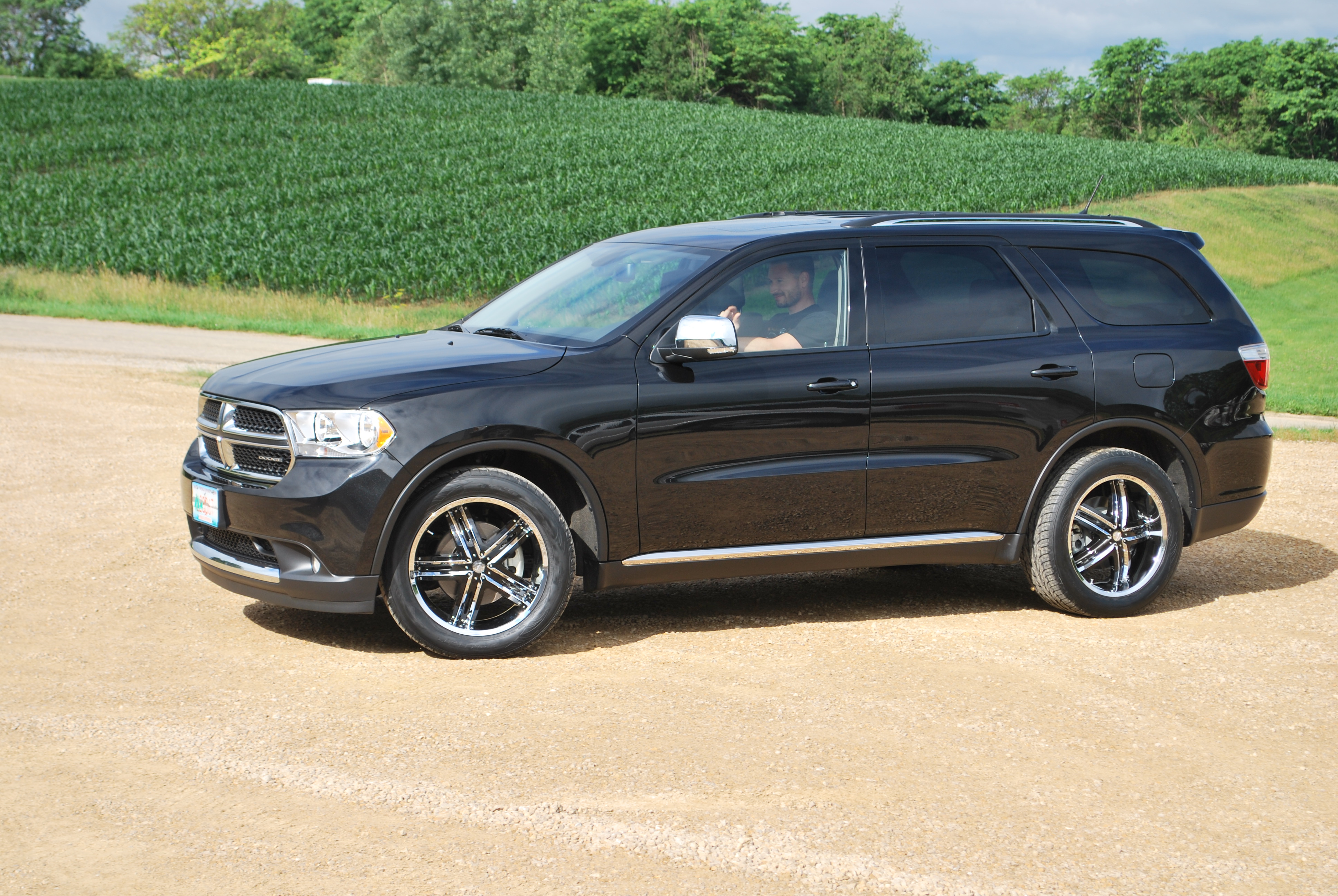

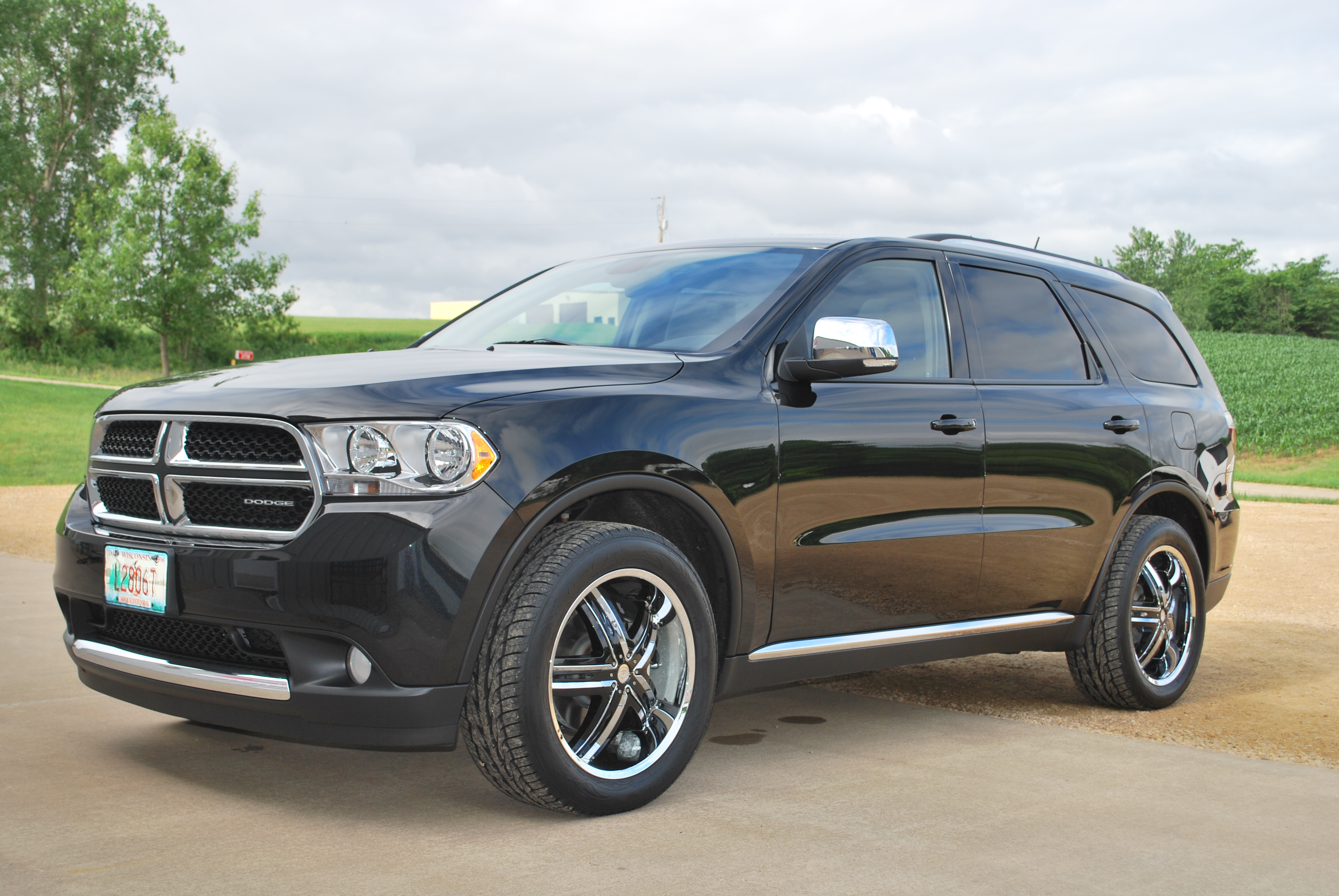

20 for a customer

actually
your going to want stock sensors
we tried a set of aftermarket sensors in the MAssiv Envious wheels you see on the Crew above.
They dont work. They would not program so we had to put in stock sensors
