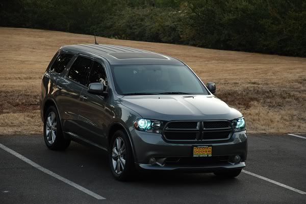

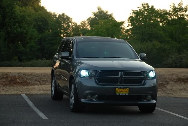

You need a capacitor (not a FLUX LOL). I ran into the same issue on my 2011 D HEAT when I had it, found out Dodges have known flicker problems and this is the work around. I paid $20/a side for capacitors from my local shop to resolve the issue on a true HID kit.
I'm told its used to trick the elec system to bypass the boost of power put out by the Daytime Running Lights (DRLs). The capacitors regulate the current to keep it constant thus eliminating the flicker. Thats what I understood, sounds good anyway In short, I've been there done it, fixed it and it worked. Actually, let me get back to you with a pic of them when I get to them in the garage. Took the kit off when I traded the vehicle in for an R/T. Some pics of the HEAT, HIDs installed:
