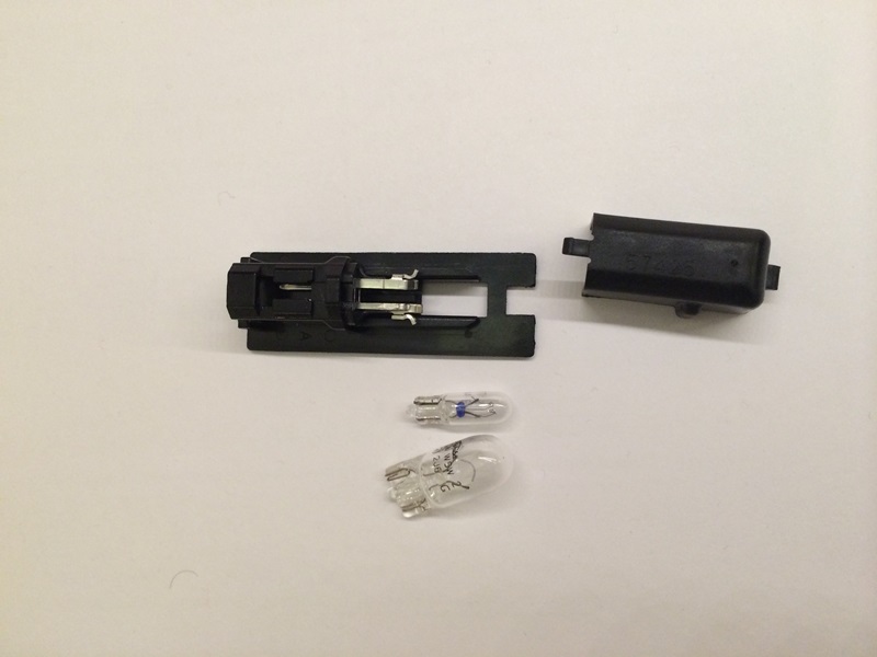

Easy peasy!! Still need to order the fog/rear LEDs. I will say this, however, the glove box light is *NOT* a 194 at least on my 13 R/T. It's much smaller than that so I wasn't able to replace it. (pic to come soon)
I'll take a pic this evening, but it's a closer match in color to the map lights, so I may not have to change those out.

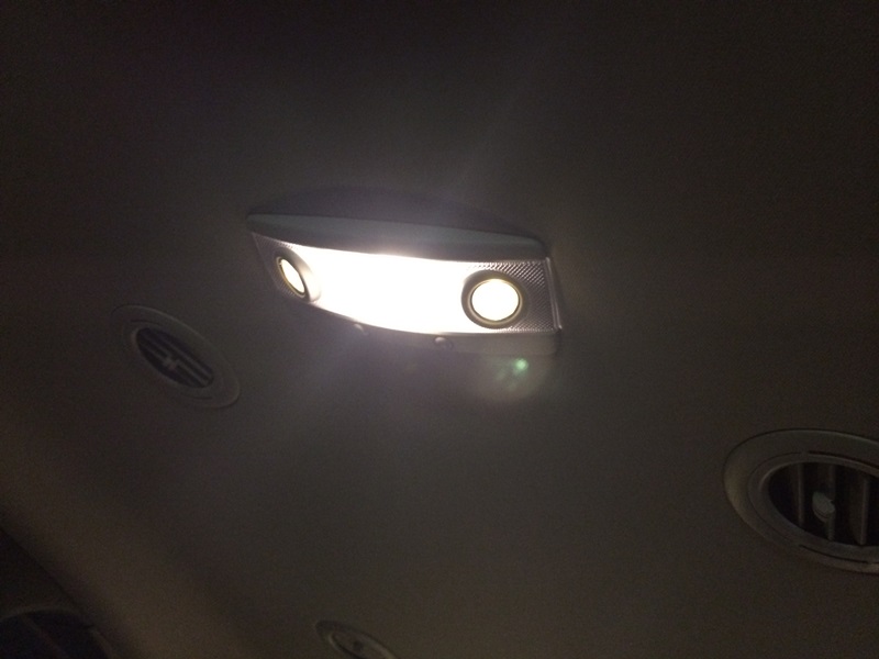

Here are the pics...
This doesn't show as well as I thought it would, but here's the difference between the map lights and the leds:
And here's a pic of the glove box light, with it's bulb next to a normal 194 bulb from the overhead console
As a final note, I'm glad I changed the lights out to leds... Both the hatch lights as well as the licenseplate lights had already started to melt the socket they were in and I had to work to get them out. I've only had the truck for 3 weeks and this is already an issue?? Wow! poor design decision, I guess...
