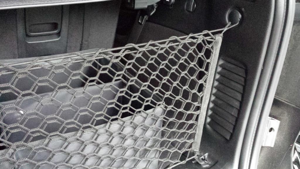

Default Cargo Net installed
The 13's have factory hook ups as well, I just put one in. Tried out one of my friends from a JGC and it fit perfect, picked one up from Amazon $25.00, listed as:
(2011-2014 Jeep Grand Cherokee Cargo Net-Mopar OEM)
