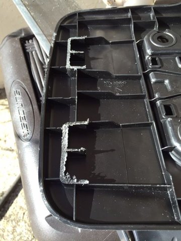

I finally got my mini console in;
$113 for all the parts. There was only 2 problems I ran into;
1.) Small bolt (w/ 3/16" Allen at the base of the seats wasn't long enough so I used the new ones I purchased (they were a little long just used some fenderwashers and it fit perfectly)
2.) There must be something different from the two options (besides the different carpets) because it didn't sit flush with the floor. There was a little gap (approx 1/2") that really bugged me. So I removed the 'extra legs' and it sat perfectly flush with the floor.
