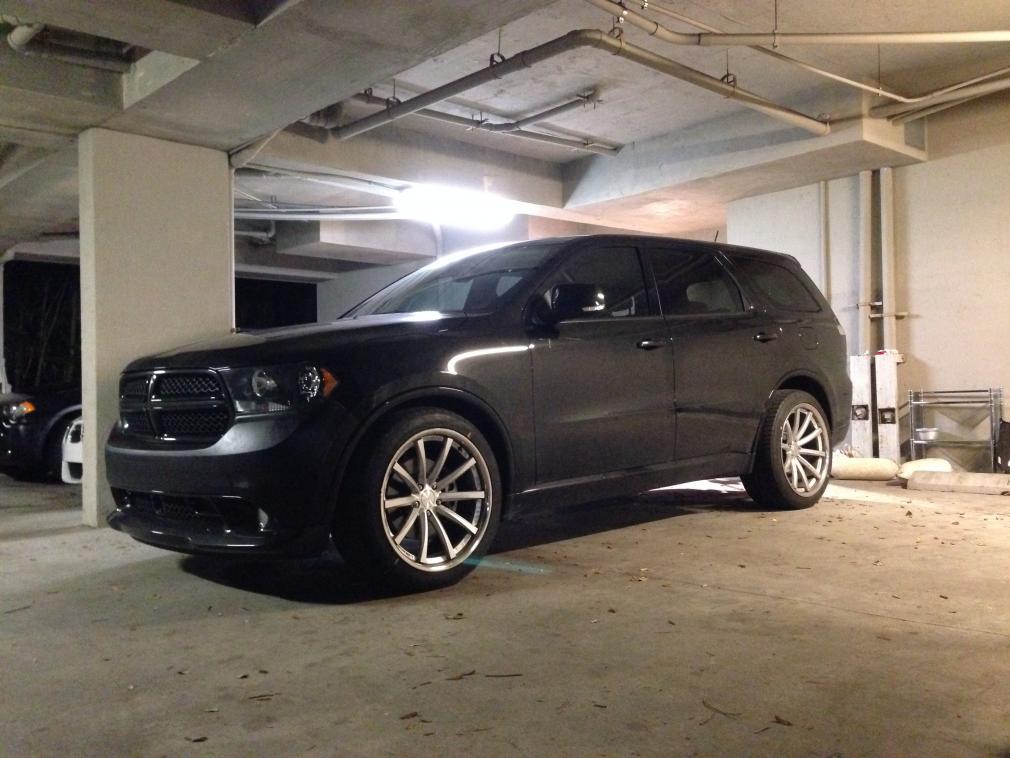

Hello everybody, I just switched the 20' oem for a 22' set on my r/t and everything is ok but a shimmy at 60/65mph. Wheels and tires were balanced and road forced 4 times and they are ok (hunter 9700), the technician swear that the set is ok, and since he didn't sell me the set there is no interest or need to lie, besides that he didn't charge me a penny since the first time he suggested me to make it check somewhere else to have a second opinion so I took it to the dealer to find out that all parts are ok, then to Sears auto care to get it balanced once more and another guy there told me that he was thinking that the front wheels were cupping, so I did 600 miles last weekend in order to get them even. The light shimmy still there…is not a shake but a light shimmy that is gone…and back…I will really appreciate any advice or similar experience that could help me out to keep this set.

Well, my set is 285/40/22 toyo proxes st II on cv1 vossen, in my humble opinion their are not a cheap set and there wasn't needed a lot of weight to balance them, in fact a few oz. But what drives me nuts is the shimmy at 60 that goes and come back with no sense.
Personally don't count on Sears in order to make a serious job but a second opinion. I'm with you Steve regarding the worn out, I feel them more stable as miles go up. Whatsoever I'm looking for any advice or theory that can help me out to keep this set.
