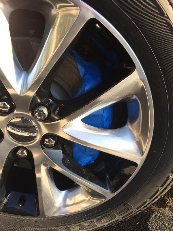

Prep is key! I washed the wheels. dried it the best i can and then went to home depot to get items. when i got back, i used the dust remover to blow the extra water out of the lug nuts and tire valve.
when the wheel is dry, i taped the brakes with painters tape

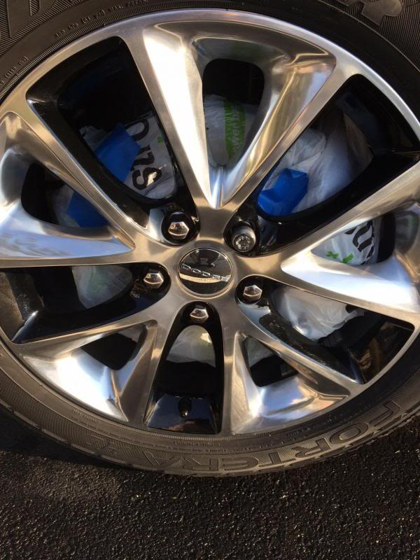

then i put additional grocery bags to cover brakes and rotors

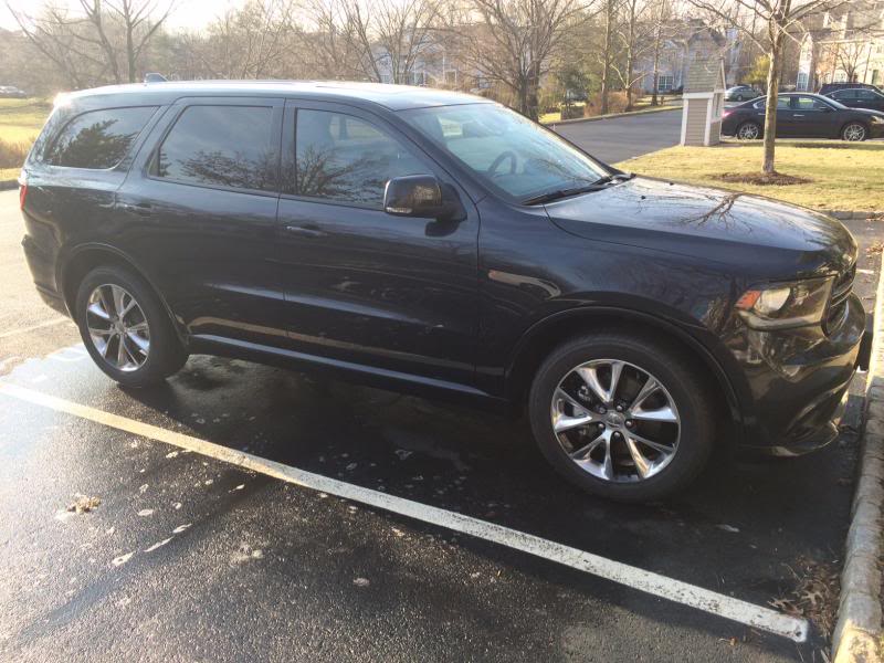

before:
]Name:  photo2.jpg

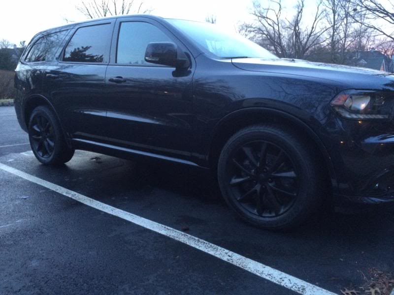

after:
i will be doing it again once it gets warmer. there are a few spots, where its not perfect. also, i was not generous enough between wheel and tire, so i dont have a nice layer to peel off my tire. its thin so its just kind of on there now
