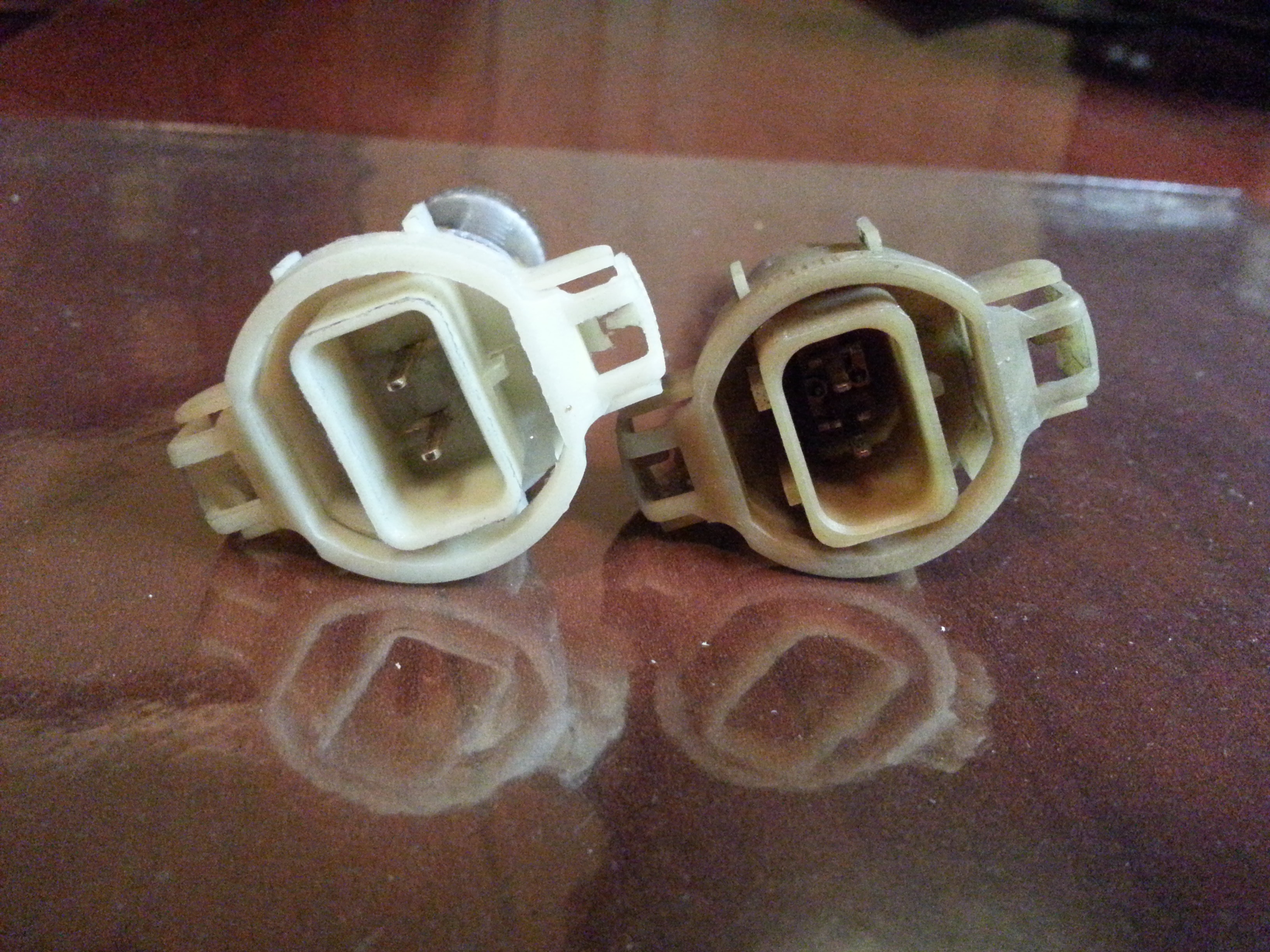

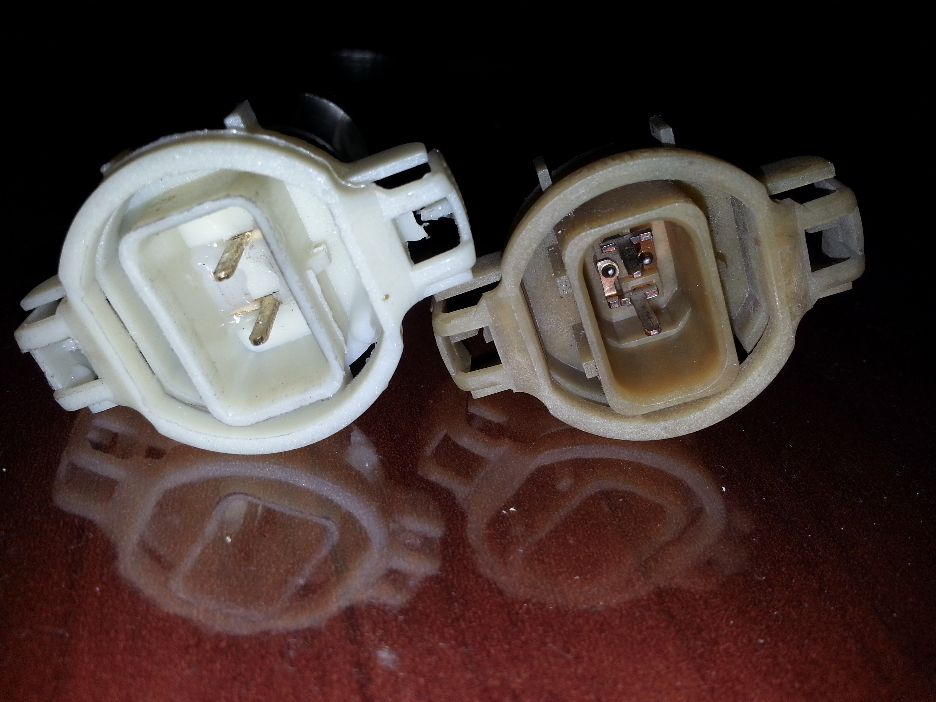

it could be the tangs inside. take a picture up close of your stock and LEDs ?? what number LED did u buy

its a 2011 crew lux. gonna go pull the leds out now and take photos side by side. but i did look and they seem to be the same with the tabs in the same location. i might have to press in a little harder as i couldn't get the stocks back on. and i looked up close and nothing seems to be broken where the tabs snap.

i had to trim mine a bit to get the leds in

thanks man... think i'm gonna have to trim as well.
these before i trimmed... hope this works. driving 3 hours tonight. lol
