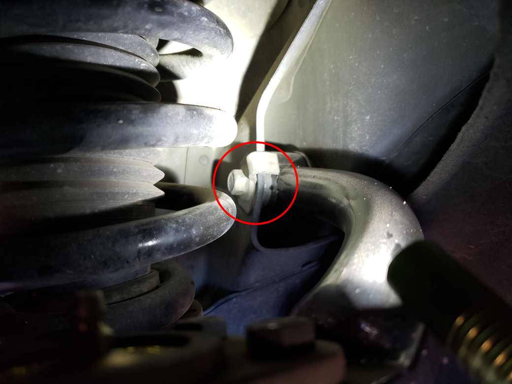

Just had my RRO kit installed a week or 2 ago.
I'm no gear head, but for someone that knows what they're doing the kit should only take 4 - 5 hours to install (with control arms).
I had mine done at a local 4x4 shop for $400 (4 hours of labor)... and of course the alignment (another $70).
What I did was call around to all the 4x4 shops to see if they'd done a DD lift before... I went with the one that had done a few before; their rate was $100/hr.
I'd suggest you check the work when you pick up your DD.
The mechanic that did mine left an upper control arm bolt tab rubbing against the mount (my terms maybe off here).
It was making a squeaking noise on bumps. I needed to have the bolt tab cut back a bit to leave a few MM gap; squeak gone.
Pic below shows where it was rubbing, though it's not easy to see in the photo.
