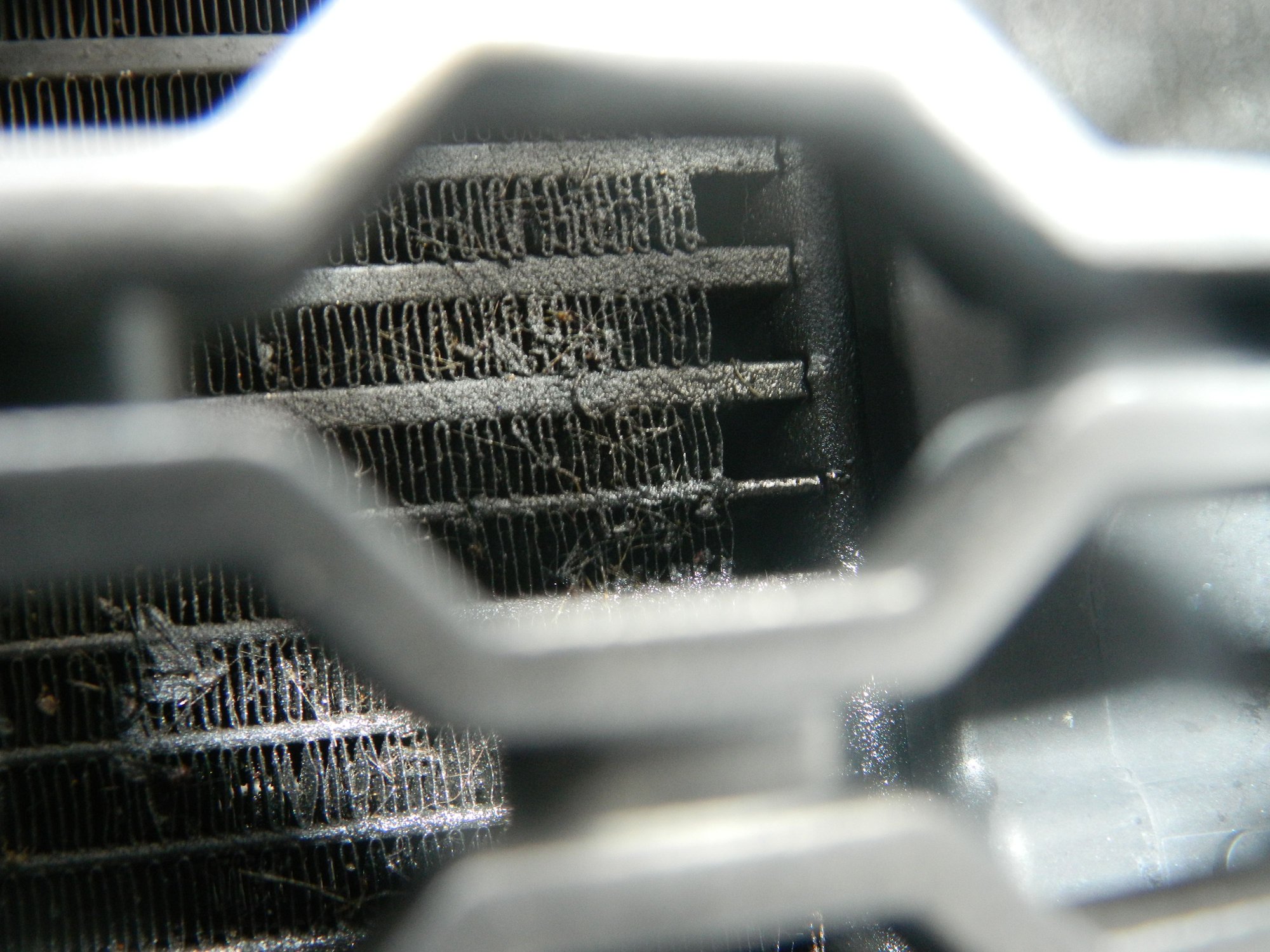

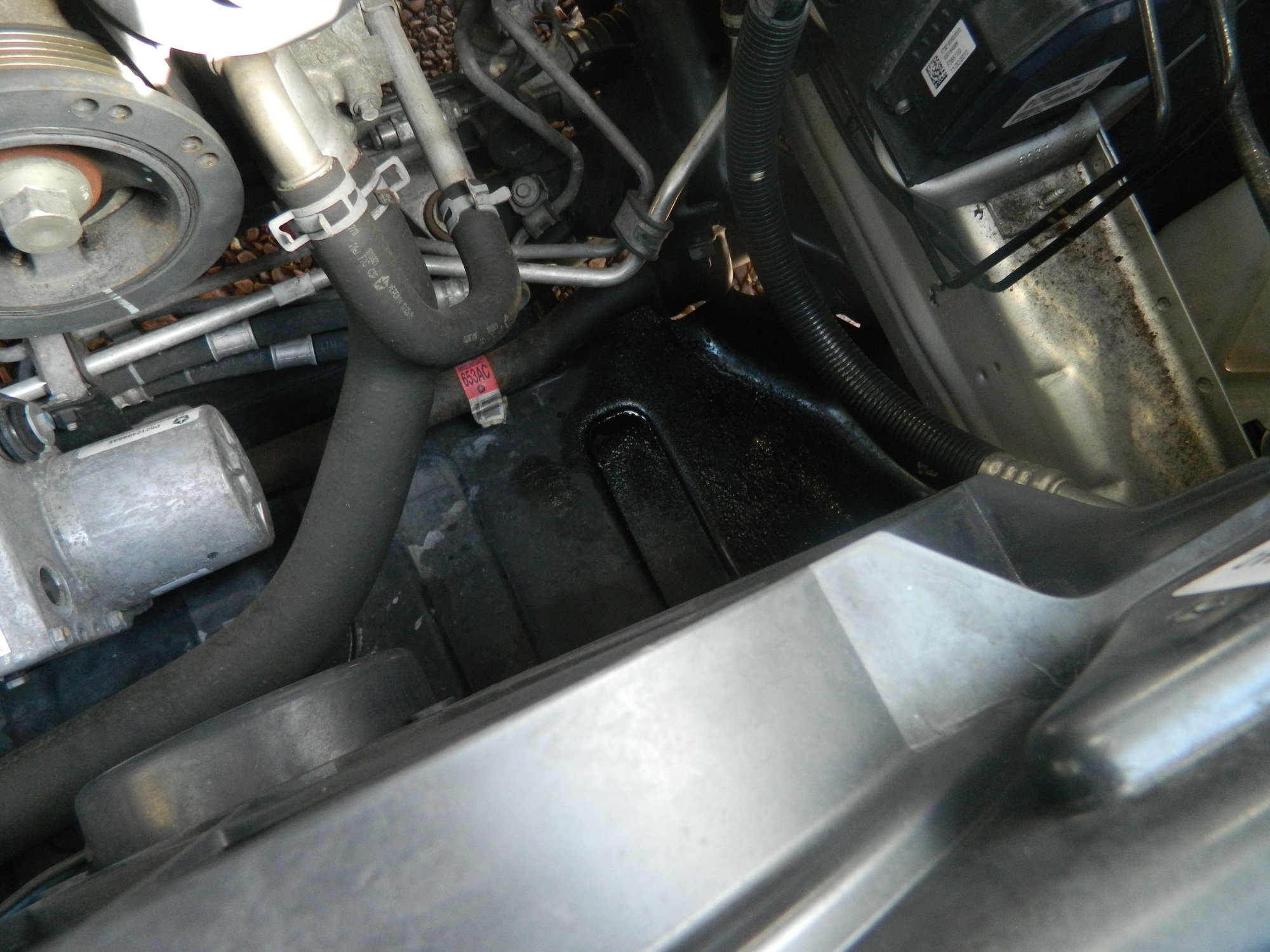

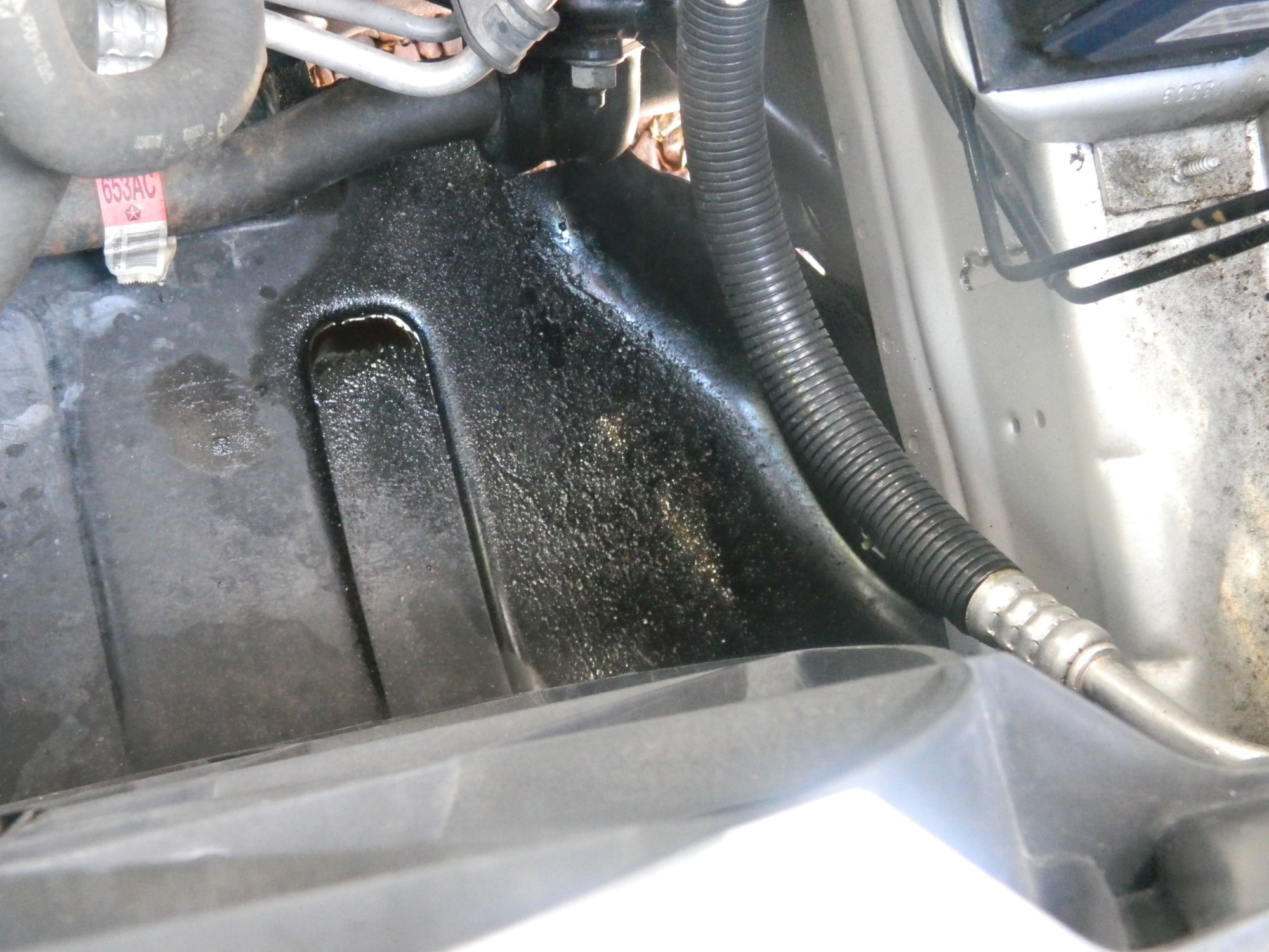

Where I think its leaking at.
Old May 12, 2015 | 10:39 AM
Posts: 28,198
Likes: 363
If you don't have a transmission dipstick, it's a dealer only service. My Journey is like that. Looks like that radiator has a crack or hole. It's gotta be changed.
