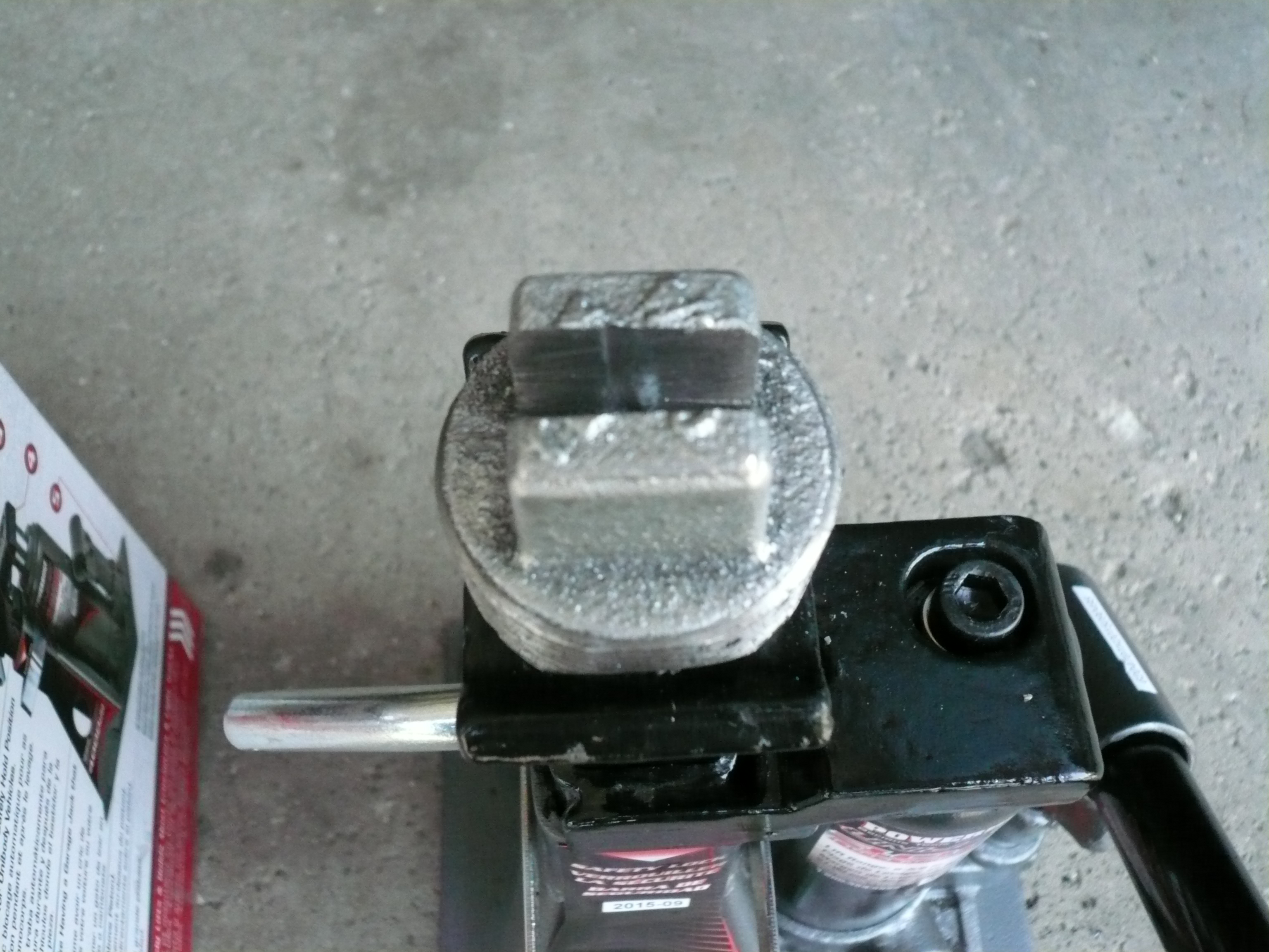

I bought the 4000 lbs (2-ton) version of the Powerbuilt Unijack Hydraulic jack/jack stand combo, and a 1.25" pipe fitting/end cap in the link below:
https://www.google.com/search?q=stee...LhIeHgQRBIM%3A
I cut a slot to clear the pinch weld, drilled and counterbored a hole for a screw to locate it on the jack saddle, and I had to file the edge of the threads on 2-sides to seat flat between the lifted saddle edges.
On the jack's saddle, I just drilled a blind hole for the locating screw to fit in. Pictures are attached.
I found that after positioning the jack under the recommended lift areas I had to lift the ratchet bar to the 4th hole position and insert the locking pin to get 2" of clearance between the wheel and the floor at maximum jack extension. With the jack stand locked in place I'll be safer when doing tire rotation and suspension/brakes inspection.
