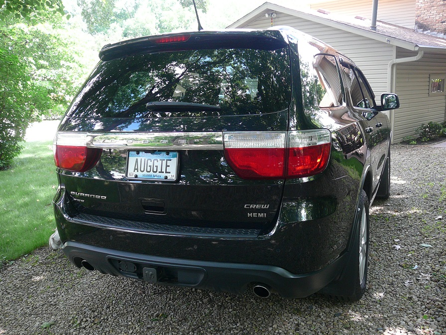

Any Idea on how to change the bulbs in the passenger side taillight ??

Remove interior trim to access the nuts holding the taillight assembly.

Are all of your taillights out, just the liftgate bulbs (2 of them per side), or the taillight/brake light? I don't see any lights working in the image which is why I ask. The taillight/brake light is much easier to change than the liftgate bulbs, but it looks like the prior posts have the process to change them covered. If all the bulbs are out on the passenger side though, you might be looking at a wiring issue....
