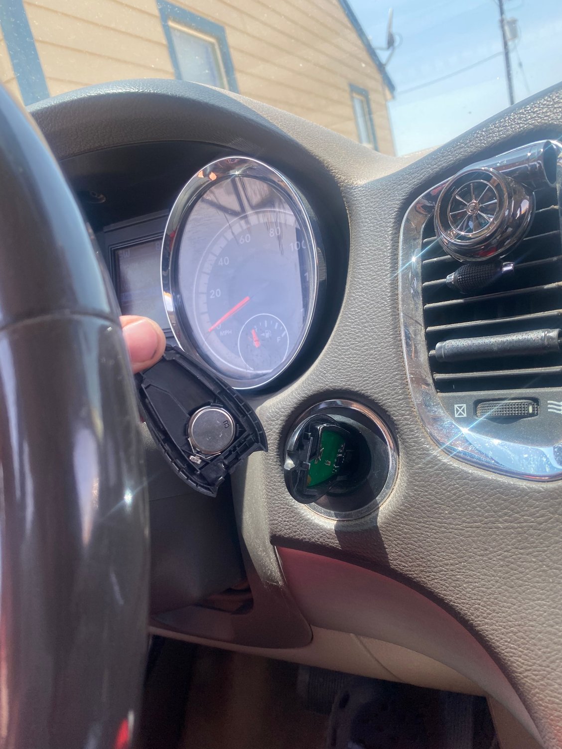

i took the battery out and started it waiting for a message saying low battery but it didn’t come on so would that have something to do with it?

Old Jun 13, 2022 | 05:03 PM

A new, fully charged battery should read more like 3.2 or 3.3 volts when not under load. At 3V with no load, it wouldn't surprise me if it were warning of a low battery. If you were to load that battery you'll probably read something quite a bit less than 3V.
What are you measuring when are you measure 1 ohm?
