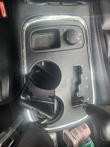

Well if I was confused before now I'm even more confused. This is my wife's car so I rarely drive it. I just looked at it and here is a picture of the console:
Spoiler
That sure looks like the new switch.

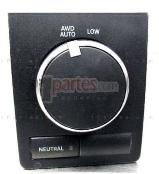

If I browse the net this is what shows up for a 2011 console:
So do I already have the new bezel which would accept the new switch?
Dealer said nothing but they probably just saw that the 2012 bezel won't work with the new switch and that was that. Could the bezel have been changed during the 2012 model year?

Maybe. If you bought it used, a previous owner may have updated it as well.

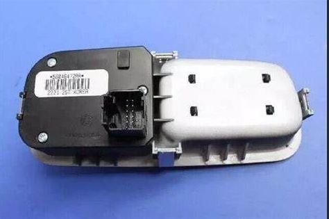

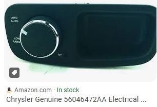

No, bought it new in Jan 2012. Plenty on online pics of the new switch (56046472AA). Not many of the old switch (56046137AC) but I did find this:
Which matches the one in the 2011 console. So it looks like Chrysler's records are wrong and my 2012 has the new switch ???? Very confusing.

Not the first time the documentation has been wrong.... If swapping out the switch solves the issue, run with it.
