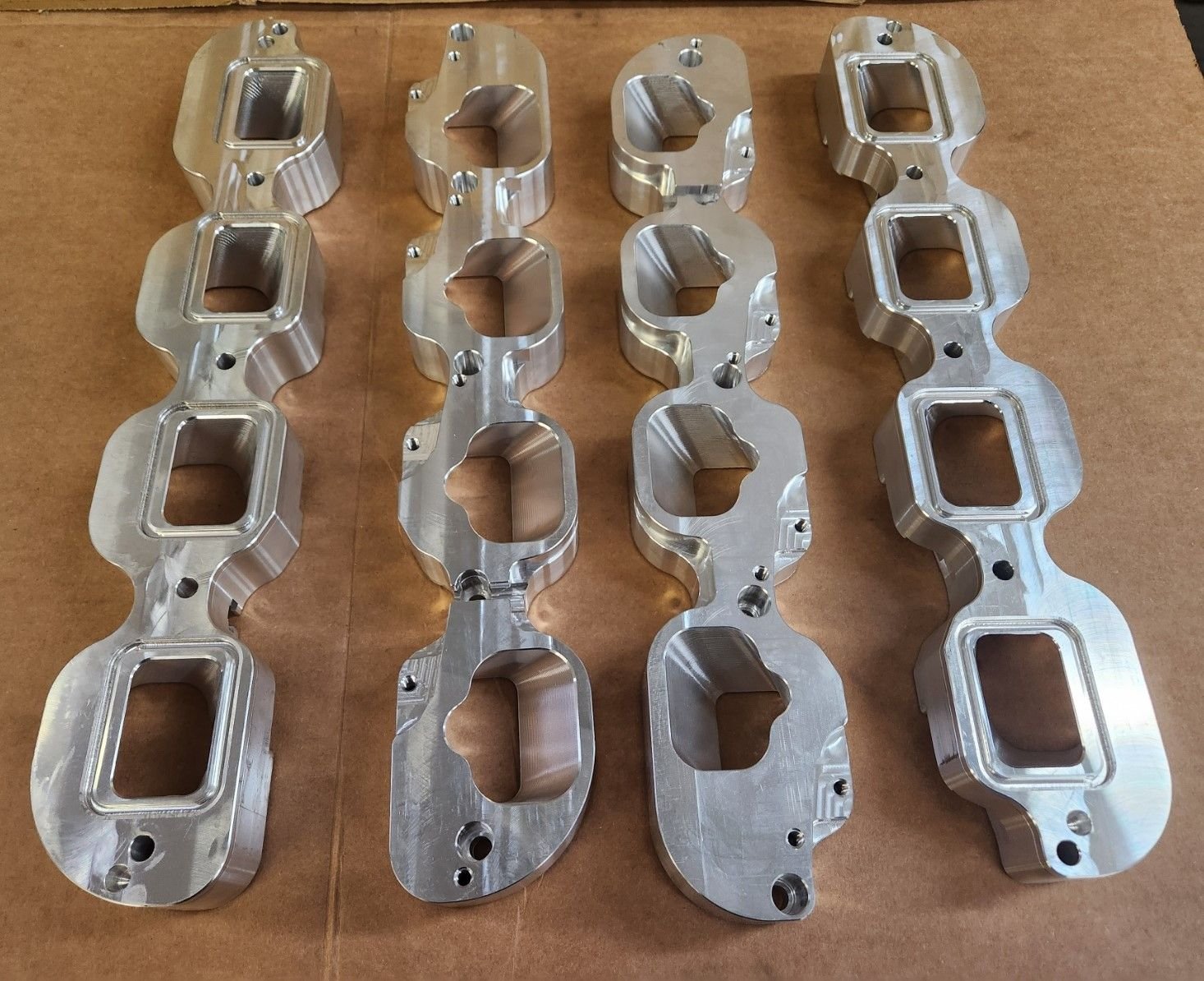

pic for attention (AirRam Dodge 4.7L heads to Ford/Sullivan hi-rise intake manifold adapters from automotivemachine.com)
