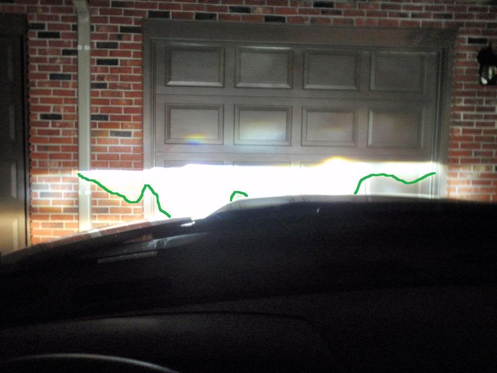

HID’s in aftermarket projectors, while better than regular halogen bulbs, and HID's in the stock halogen reflector housing, are not as good as HID’s in actual, real HID projectors. I have HID’s in aftermarket projectors, and after I’ve seen how the beam pattern is, I’m getting my stock lights retrofitted with HID projectors. With the aftermarket projectors, the beam pattern sucks. The beam pattern of the stock lights with the halogen bulbs is much wider and even than the aftermarket projectors. If you look in this picture, obviously you can’t see all of the light since the picture is from inside my truck, but against a wall, the light looks like a “W". As compared with the pics dirtydog posted earlier, which show how the beam pattern of HID's should look like.

Hmm I see what you mean comparing the 2 pictures for sure.. Have you looked into how much it costs to get the actual hid projectors fit into the stock headlights? I melted 1 while gettin them apart to paint. soo im in the market for new headlights, i wanna go aftermarket projectors but if its not to much I can buy stock ones and get the projectors put in..
