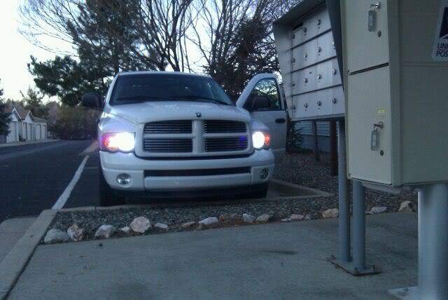

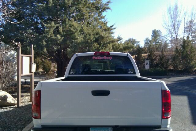

Finally took those emblems off and got around to put my hids in let me know what u think! Next mod is a leveling kit!!

debadging looks good, what temp hid's did you decide to go with?

looks good! white is my second favorite color...

very nice man!! will look good leveled too!

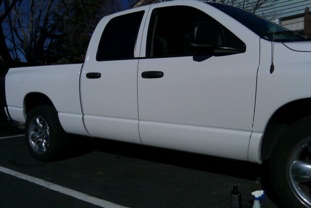

thanks i went with 8k sorry last pic was suppose to be this not a dupilcate

Great look on the truck!!! What is the best way to do the debadging??? After I debadge my truck I then have some other emblems I want to re-install suggestions for that, or is 3M tape best way to go??? Thanks for the answers and help in advance.

i just used a piece of fishing line to remove the emblems and a plastic razor blade to take off the tape left behind then used a polishing compound to buff the remaining area!

do you just do Hedalights, or fogs too?

i just did headlights for now gotta wait another paycheck to order fogs!
