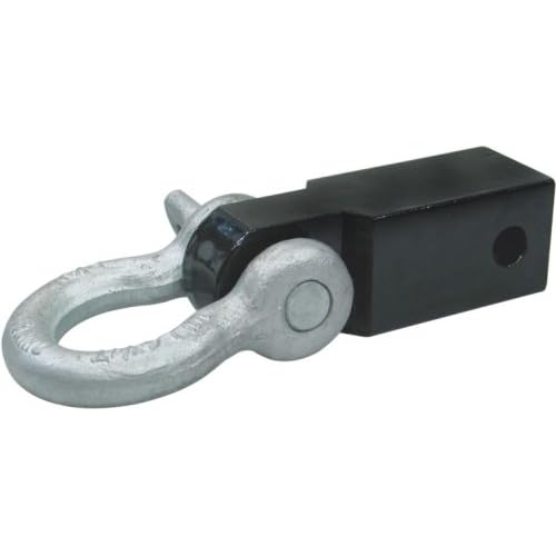

If you are going to attach to the rear of your truck, then pick you up a receiver mounted tow hook for about $20 or even better a receiver mounted shackle for about $35.

I kind of like the idea of the loop shackel on the back and a recovery strap with no hooks. I'll start looking.
