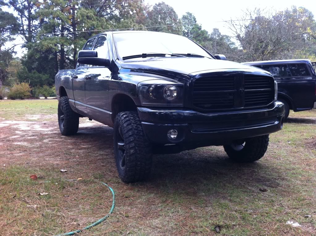

having tires that stick out so far really kill your paint and make it impossible to keep clean. Im getting flares in awhile hopefully but it still wont solve the problem completely.
Like Hammer said, you could buy rims to give you that stance. I have spacers, but supposedly some people have had trouble out of them. I tow a 26ft ski boat, and regularly tow an 18ft flatbed filled with whatever all the time and haven't had any problems...YET. lol knock on wood
These are 12.5s on factory rims and 1.5in spacers. Im not sure what that amounts to but they stick out quite a bit for me.

Ahh right on guys, thanks for all the info. Just for looks, maybe 2in is a little bit excessive. I like the looks of yours Matt, thats about all im looking for as well. I don't tow much besides a 2 place sled trailer, but i often carry a bit of weight in my box, i use the truck to haul roofing tools and materials. Im not sure about the law's around here, i live in Canada, AB, but hopefully i can avoid tickets haha. Thanks for all the help guys, i think ill just aim to get the rims with wide tires for starters. If i cant find what i need maybe ill consider the spacers
