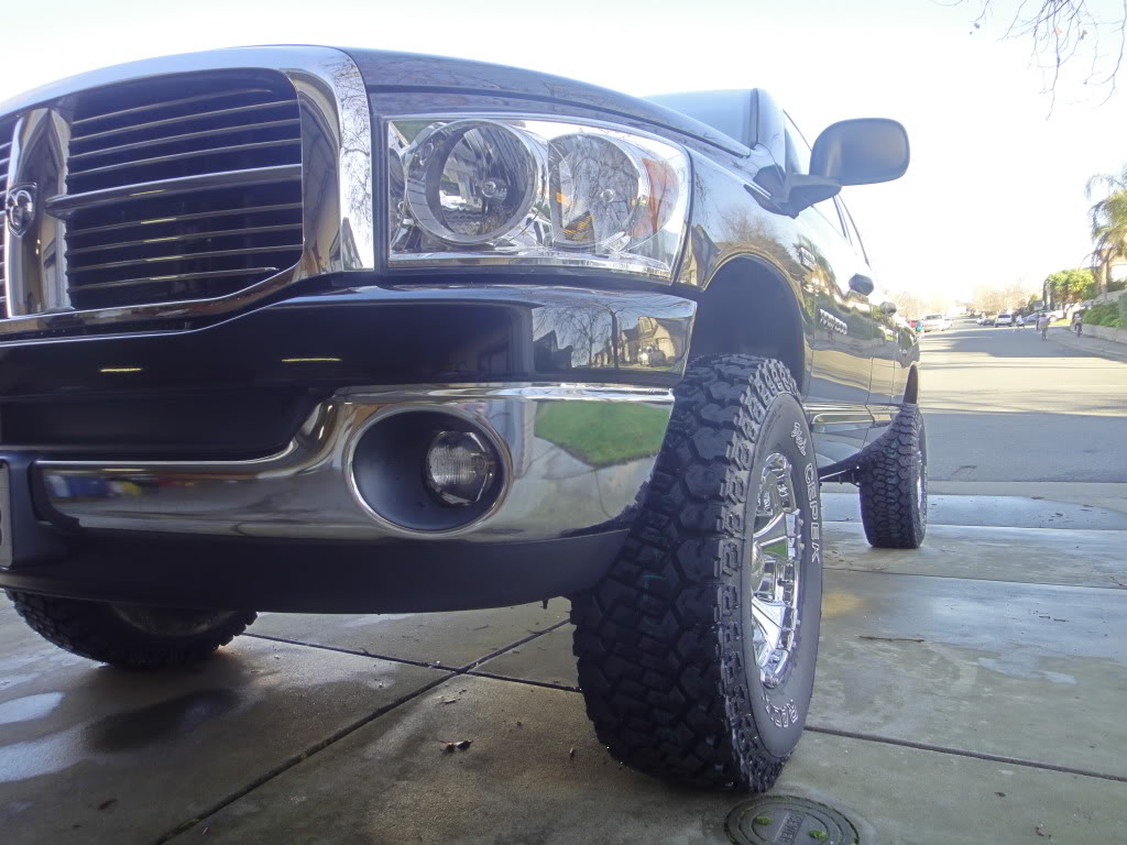

4.5" backspacing with 35x12.5R17 tires
Size:  126.9 KBName:  DSC05049.jpg

G-dog..... THATS WTF IM TALKING ABOUT RIGHT THERE. That looks sah-weet. You lifted or leveled or both?
