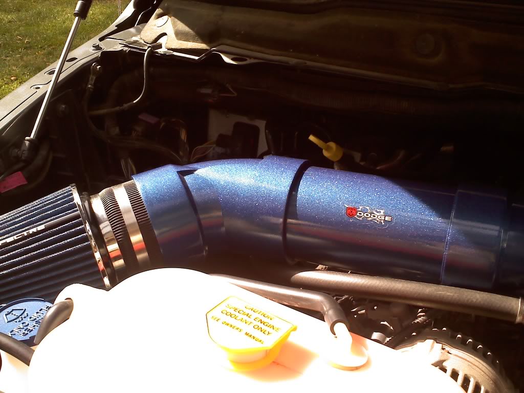

Yep, its easy peazy:

Lazy
What diameter of PVC is that?
Old Feb 16, 2011 | 08:05 AM
weedahoe's Avatar
weedahoe
Hall of Fame Member
Posts: 19,168
Likes: 23
From: South GA
3" is the most you need to do as that is the I.D. of the throttle body.
Thanks Weedahoe! I knew 3" was the common size, put the pipe in the picture looked bigger to me.

Thats because some guys use 4" but IMO is is a waste and overkill

Yes, it's 4'' pvc, and reduces to 3'' after last turn to throttle body. My thought was more cooler, less restricted air as far as I could get it the better. I know plumbers, so the fittins did'nt cost me anything.
