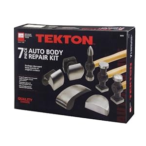

They make these wonderful dent repair kits you can get at just about any auto parts store for all of about $25. I've had one I bought at a NAPA on one of those sales where they put all kinds of crap that's sat too long on tables outside and paid $12 for mine. I bet I've had that thing since about 1996 and it even comes in a plastic case with foam cutouts for all the pieces!
I've used it a few times. My ex mangled the the tire fender on my bass boat trailer once when she got a bit too close, I mean bent the summbiotch down into the tire and I removed it and banged it perfect. Other than the fact the spray paint I bought and feathered in was off by a shade or two and my hand wasn't steady enough to make the little silver pinstripe perfect, you'd never know how mangled it was.
Mine is very similar to this one which is on Amazon.com for all of $19.
Obviously, you'll have to remove the bumper and bang it from both sides, as I had to do with the fender, but with the curved pieces you should be able to get it factory new...

the kit hammer mentioned is perfect. At napa it will be considerably more, obviously. It will never get out completely, you will have creases, but it wont be as noticeable.
Your best bet is to strip the old paint, maybe a wire brush on a drill, then a good thick etching primer, get some base (you can find duplicolor at auto shops, but its in 8oz cans and kinda expensive. call your local body shop and ask where they get their paint, and call them. They will be able to mix up a spray can for you.) Then a good clear, the paint house could also mix you up a better clear than duplicolor.
The plastic has little clips holding the whole thing on. There are a ton of them. Just squeeze and push through is what I did. Might as well paint that while its off!

yeah i was gonna say, napa did not have the hammer set in store. in the catalog it was for $195. i'll pass on that, i can order a new bumper from LMC for $249 or so. once i find this hammer set, i think i'll be set. i figured i couldn't get it out completely, but as long as i can hammer it out and get all the rust off, i'll be happy for the time being. and reefguy, go figure, thats the exact spot as mine. sucks...its crazy how one little dent will throw off the feeling about the truck..for me anyway.
i'm gonna check AZ and AAP for this hammer set. maybe even oreilys..

Anyway, they had the one I bought up in the NAPA in Vidalia on that "side-walk sale" for $12 over a dozen years ago and it was selling for $79.95.
This one is on Amazon.com for $16 + shipping at one location or $24 w/free shipping at another.
I think I've also seen the at Harbor Freight and I know the hardware place at my local flea market has them for around $15-20...
