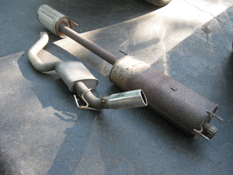

I have Magnaflow muffler #12198 on my 07 Hemi quad. After doing a lot of research, I easily decided on Magnaflow. This muffler is a 14 inch, single in / dual out design. The install was custom, both resonators removed, all pipe connections were welded. The sound is clean and agressive, with a nice V-8 rumble at idle. If you are not looking for agressive sound, you should go with a longer muffler, and perhaps leave the resonator(s) in. Also, my setup drones when the MDS kicks in and out at cruising speeds. I attached a photo of the stock exhaust components that were removed from my truck, and a shot of the rear as it is now.

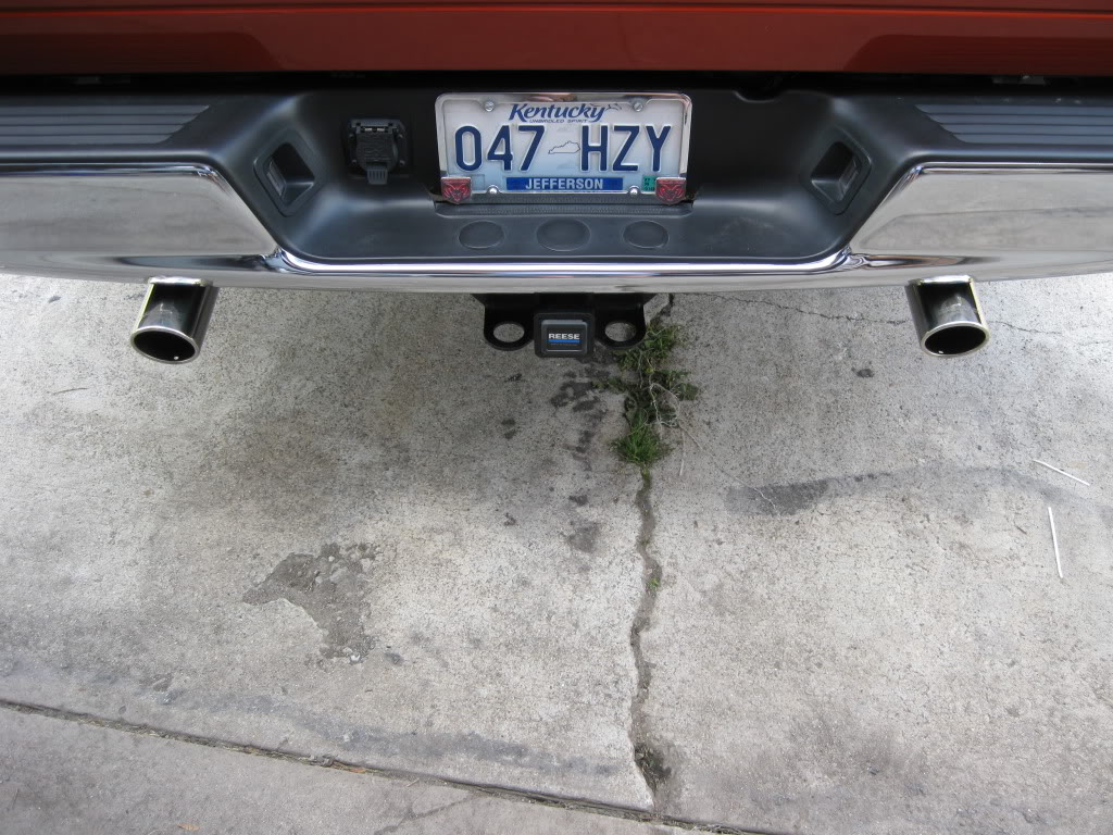

The 08 doesn't have the front resonator so you don't need the midpipe like the 06/07.
My Magnaflow 16700 cat back right after install.
