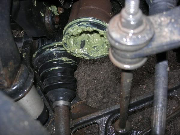

I'm not saying you CAN'T run tires that big, guys do it. I'm just telling you the problems you ARE going to have. If you can do your own work, know how to swap a snapped CV joint in the field (side of road) and don't mind replacing ball joints, tie rods and especially the pretty weak rack & pinion then you can probably get away with it for awhile.
But a SFA (solid front axle) truck will handle that kinda lift and that size tire infinitely better.
Guy in my hunting club had a shop tell him "no problem" doing 37s on his Z71. They didn't give a sh*t, just wanted the money for the lift and labor. I pulled him out the woods hunting with this only 3100 miles after he put 37s on:

ouch that doesn't look good
