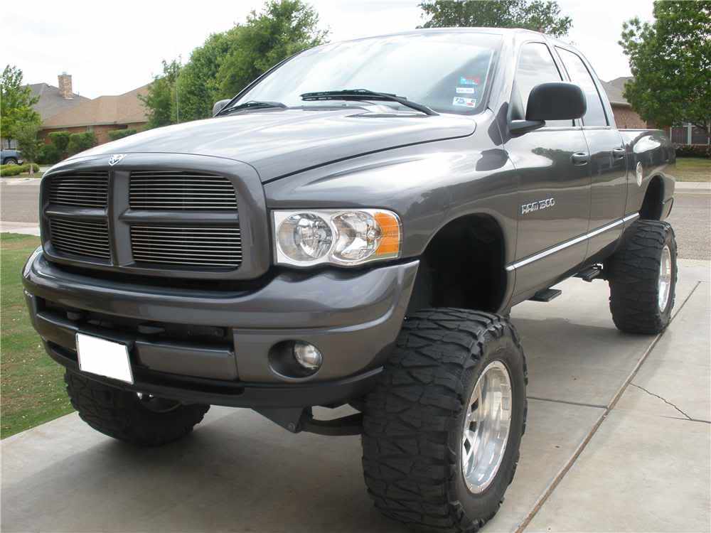

Ill cut to the chase, I want to make my truck a sort of show truck of some sort. lift it maybe 6 inches with 37's. What type of lift is decent but still wallet friendly? I will not really be offroading it maybe 2 times a year. I was thinking about different gears too heres a pic of my truck and a pic of another ram kind of what i want mine to look like. If thats someones truck from here....nice truck my friend I like it!

This is what i would like my truck to look similar in size to. Any other mod suggestions would be cool too

Old Jan 8, 2012 | 06:24 PM
KasperR34's Avatar
KasperR34
Joined: Oct 2011
Posts: 830
From: Wolcott, CT
That is at least a 6 inch suspension lift with a 3 inch body lift.
