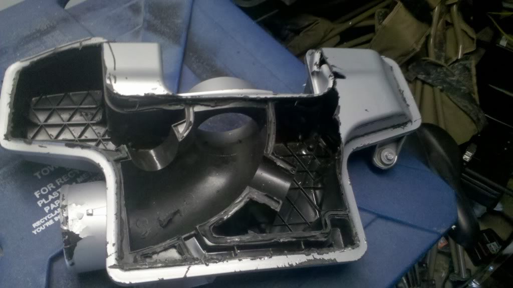

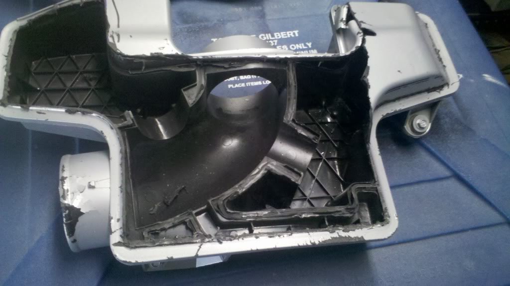

Yep, it's basically a baffle and is pretty restrictive. Replace it with anything from about three bucks worth of PVC and a $4 boot up to a full commercial CAI kit...

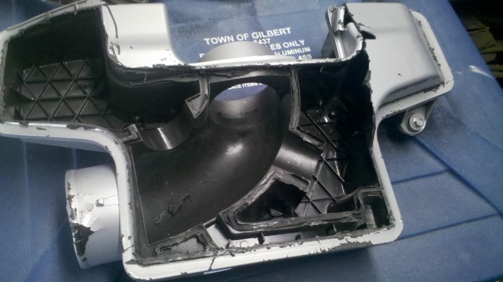

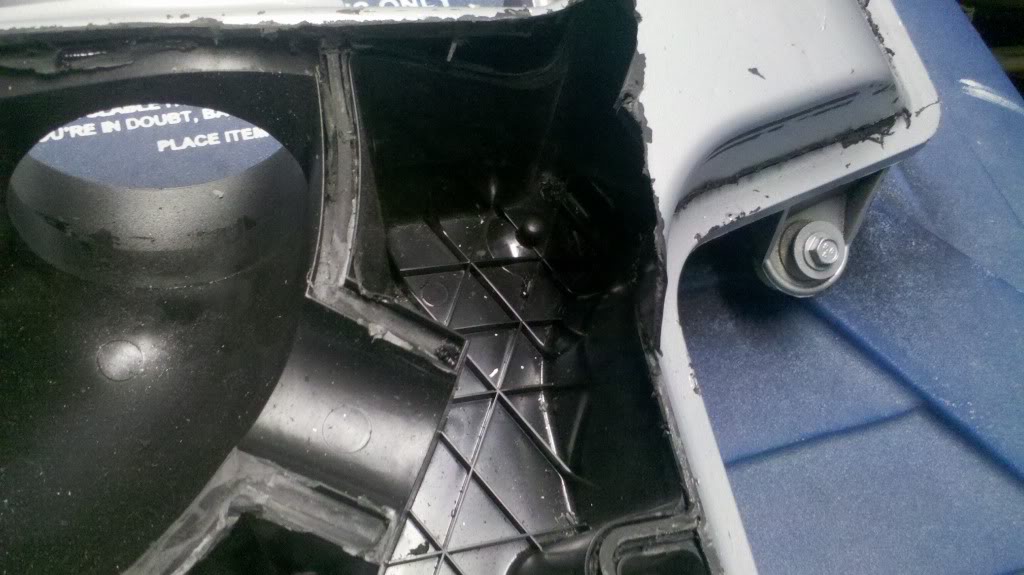

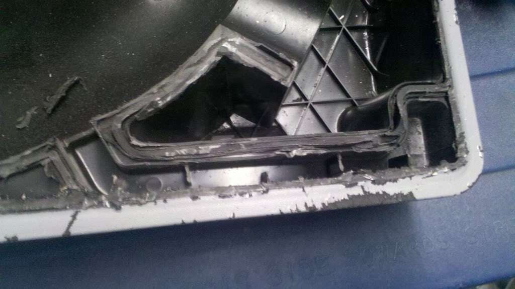

here is the inside of my stock hemi hat, notice all the chambers.
