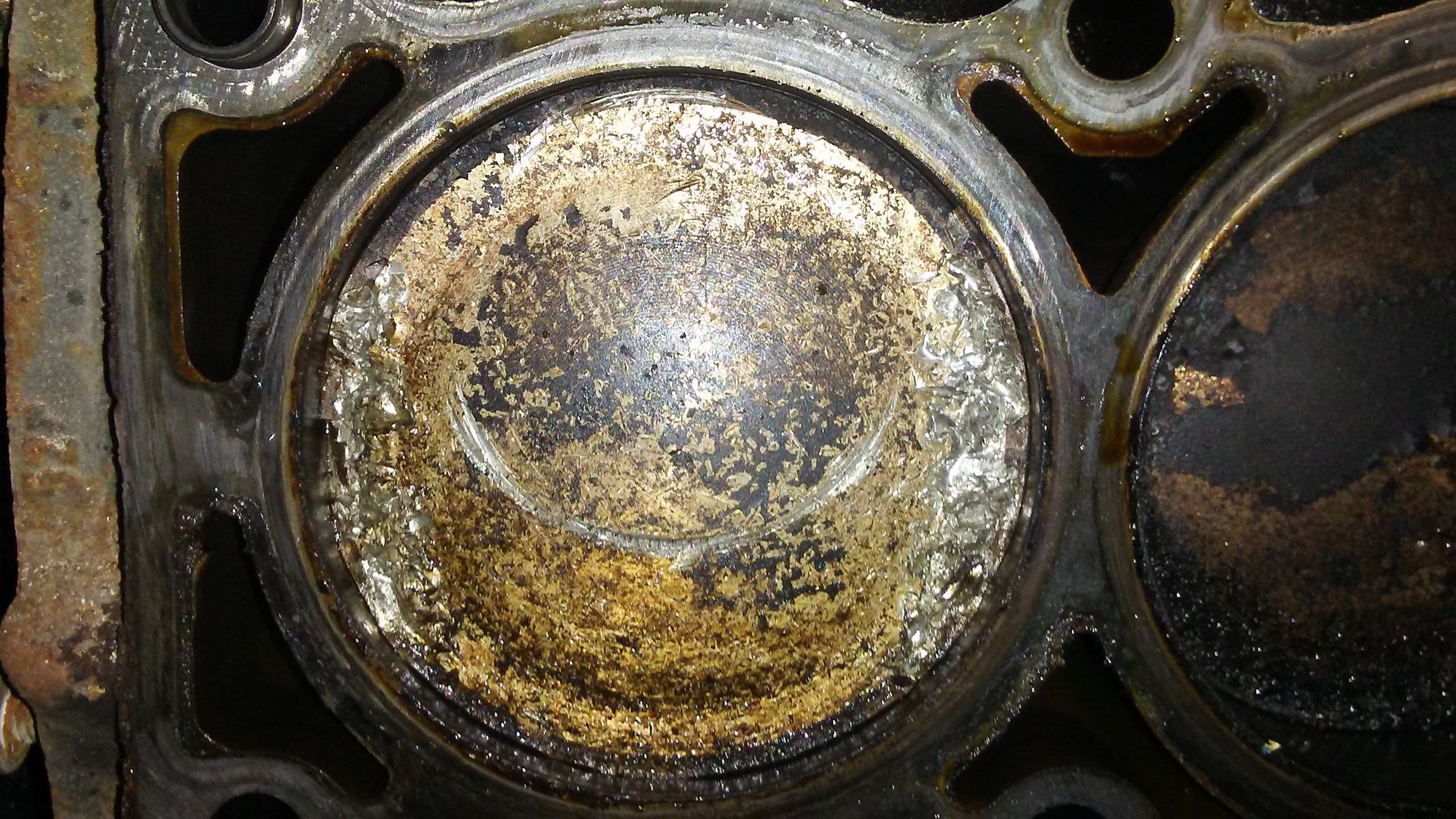

Started the motor tear down. Got the intake and heads off. Will need a right side head and will be getting it bored out. Wont be a 345 cu in anymore.

What was bouncing around inside the cylinder to do that???

A piece of the piston and the valve seat i would assume. Its kind of a good thing. Means i will get the block bored and i have a head to cut apart to compare to when i port out the heads and to practice on.

It sounded pretty rough the 5 seconds i heard it run. Bought it knowing it was jacked up and parted out the truck except the motor and trans i kept. Pulled a head at the junk yard. Best 37 dollars i spent all week. Going to take them to the machine shop to get all the seats replaced and get them milled. There was 3 hemis in the junk yard, 2 had the heads pulled and one of them was identical to my bad one. Cylinder 8 must be the most common bad valve seat or has cooling problems.

got the pistons out and timing chain and oil pump out of the hemi project build. Picture is the cyl 8 piston.

Did that thrash the block as well?
