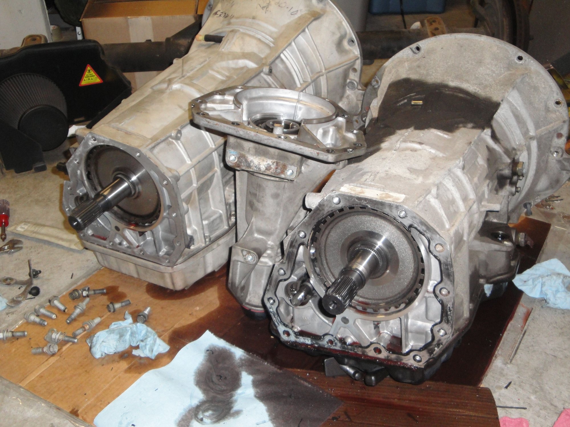

Transmission on my 2002 1500 2wd went out, I have a 2005 I believe parts truck it’s a 4x4. Wondering if the transfer case and my tail stock are interchangeable?…. My trucks also a 4.7 the parts truck is 5.7…. I’ve heard the bell housing mounts up.. wondering if I could pull its trans and swap my tail stock and slap it in my 02.

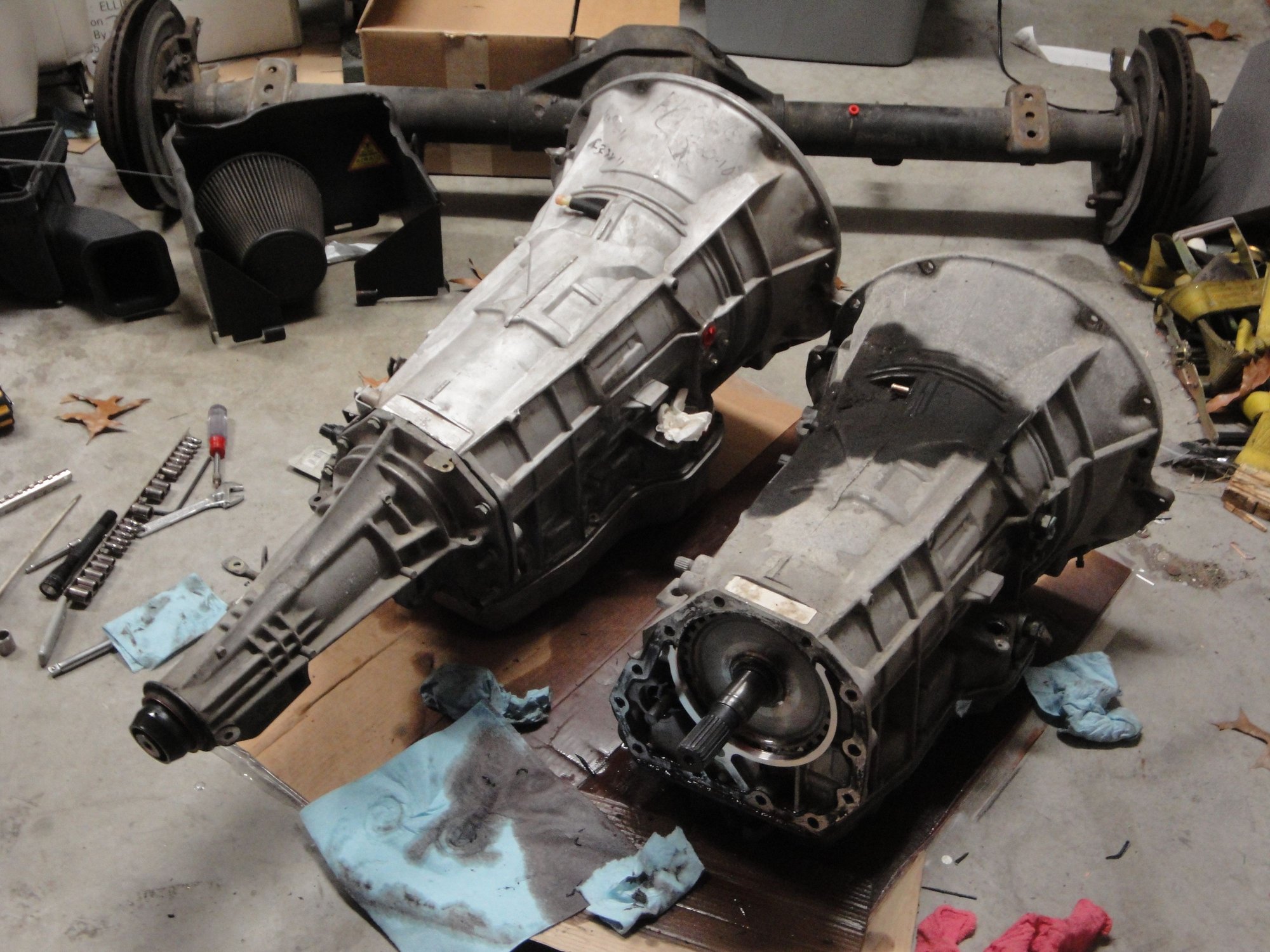

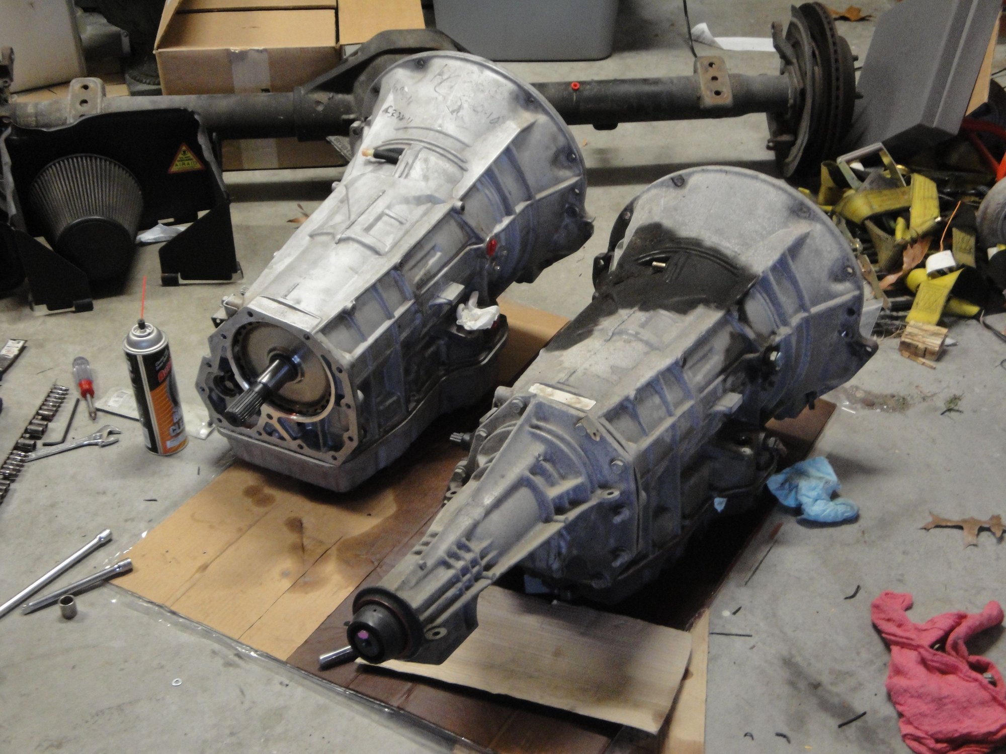

Same trans. Pull the t-case adapter off the replacement and put your tailshaft on it. There's no gasket, just RTV. The process will look like this:
