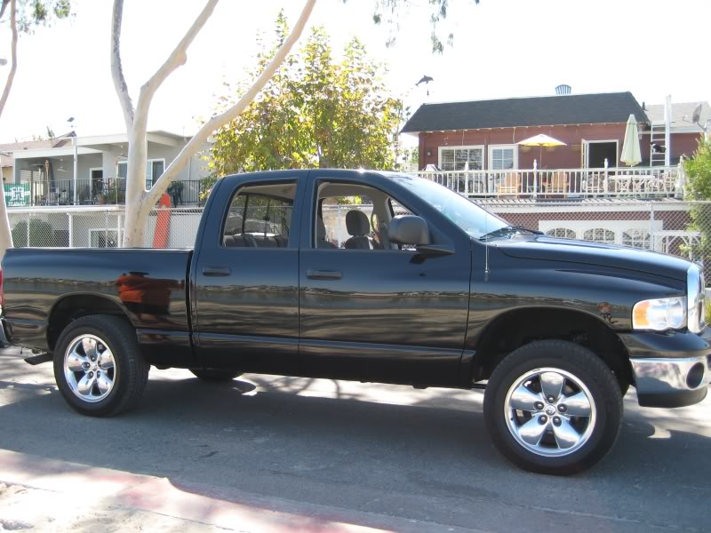

before..this one the fronts the right height but the rear was weighted down be a 8000lb trailer before i got airbags

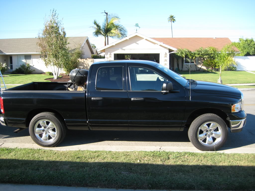

now..way better. it even had a wakeboard boat on the back

Does that level it out or wll i need to lift the back also if i go up to 3".

looks good. Thanks for the help. will try and let know how it turns out.
