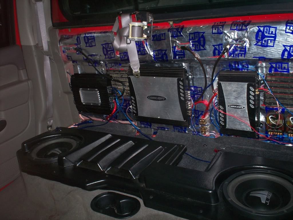

got a killer deal on some subs and amp feedback wanted**finally installed and updated pics***
Yea, if you end up making a box, good luck. It WILL be a PITA.... Fox Acoustics makes a great box. It is well made and sounds great. It has a good amount of airspace for a prefab box, and will install without you having to pull the carpet out from under it (unlike the carpeted boxes, which often require this) This has been a very popular box on DF & DT.
The subs also come with some 5/8" seat spacers to give a little more clearance for sub excursion. Here is a pic of my setup without the back seat.
I have to say I think that should sound loud as f*&@!Like everyone is saying, though, the only problem I can see would be the lack of air. You must like it loud, though, cause is that truck those will be boomin'. Call me weak, but I just downsized from an Eclipse 15" running 1000Watts to a 10" W3 runningwith a 500Watt Slash Series.Fiberglass box under the back seat seemed like the way to go. I'll tell you how it is when it's installed in a couple days. Should be clean though.

Yea, I think that the dual 12" enclosure is sealed.... Still, you will enjoy it more than an MDF box, especially the prefabs made for our truck. The dual 12" box is only $150 shipped.. which is only $30 more than the box you were originally talking about, and way cheaper than the MTX box.
As far as the amps go, I was skeptical at first that the location would work. I did not think that there would be enough air flow, but when I removed thes seats, there were the two vents (black squares, one is on the right-middle of the pic above my crossovers) I am not sure what these are for (i assume cabin pressure, but I have not had anyone confirm that), but the air temp does not get too high. I actually had an electronic thermo back there to monitor, and even when pushing the system, it was still cool back there.

What OHM are the subs? If they are 2 OHM then the subs will be getting 600 watts each, if the subs are 4 OHM they will be receiving less... The subs are rated at 750 watts RMS.
The subs require a minimum of 1 cubic foot of airspace... Try to stay above that number when picking a box.

well i picked up the woofers and the amp. its gonna be way too much for the truck. definetly not enough airspace and the box i was gonna buy (foxacoustics box) is the largest one i could find, here were the issues
1. not enough airspace (about 1.8something feet when i needed 2)
2. the magnet on the speakers were just a little too large. itll be too much of a tight fit and i dont think itll sound that good.
