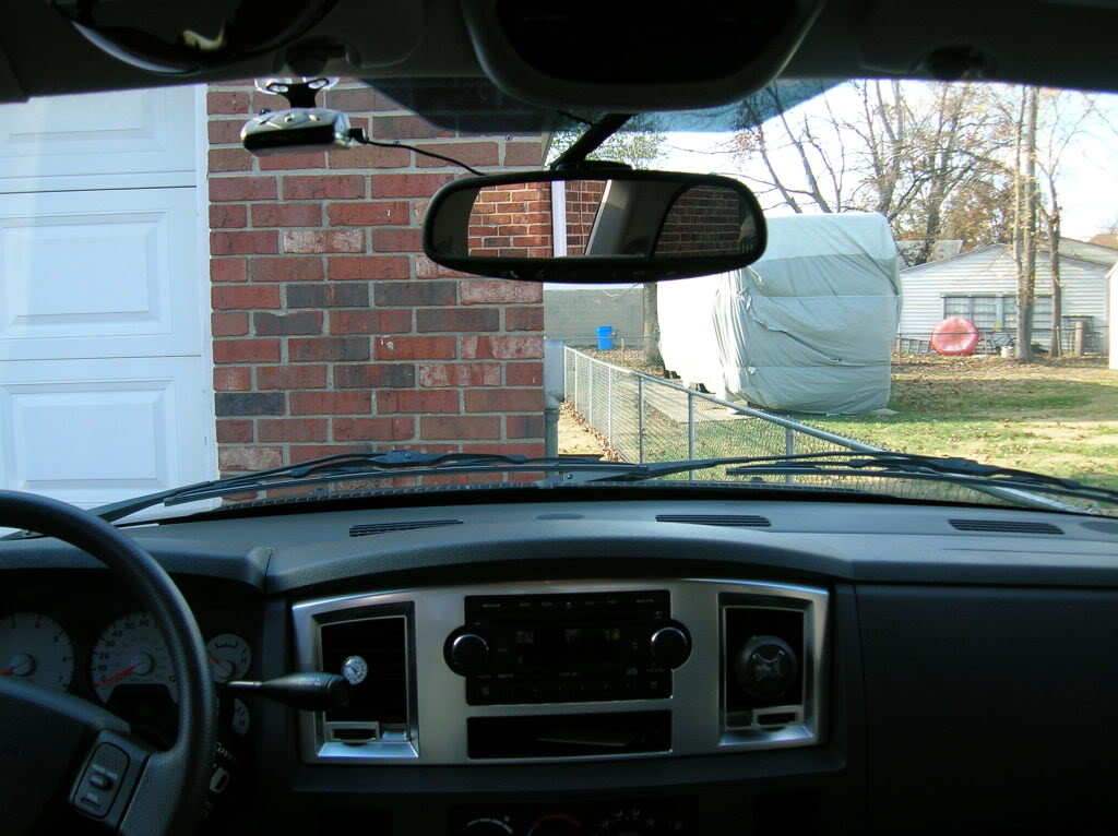

I bought a 10 piece bag of male post crimp-on terminals at Radio Shack for $1.99 and wired mine into the auto dimming mirror. If it ever quits raining, I'll get some pics. It is nice to not have the cord running to the lighter and the detector coming on in the accessory position. Not it only posers up in the run condition.
The Radio Shack part number is 64-3095.

Here are a couple of pics Name:  DSCN2642.jpg
Only powers the detector in the run position. SWEEEEEEEEEEEET!
